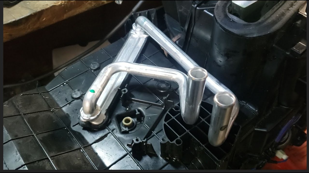

The plenum is split down the middle with a baffle, the bottom 1/2 of the core goes to the driver's side, the upper half to the pass side. The bottom starts to clog first, hence low heat to one side only.

Right on, definitely the heater core. I'd try to backflush it one more time just on the off chance you can save yourself a heater core job. Fill it up with distilled water, blow the water through with an air compressor (don't go crazy with the pressure), fill it with CLR and let it sit 30 mins, flush it again. If that doesn't work motor city mechanic has a great series on replacing it on youtube, titled something about AC evaporator replacement (heater core and evaporator are right next to each other in the HVAC box).

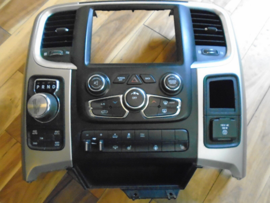

In your HVAC Controls
does the left most control knob, does it read PUSH on the knob?
If it does, maybe it can be reset.

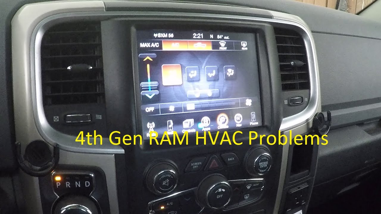

This video shows a HVAC Unit that has 5 doors & actuators
from what the guy says in the video, the dealership did not properly use the test equipment & changed the wrong actuator.
now another shop is working on it, by removing the Whole HVAC Unit

short vid on heater core service
this video may be for the Gen 3 Dodge Ram, but rebuilding the Gen 4 HVAC Unit is almost identical

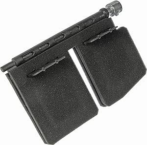

Blend door actuator or the blend door itself may have broke where actuator connects to the door.

my 2010 it was the blend door was broken one side breaks so you only get heat on one side
