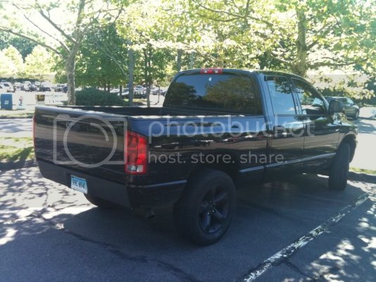

Hey how you guys doing!! I'm so glad I found this site with all familiar faces. My job has blocked dodgeforum.com and I use the internet at my job since I hate using the internet out of work lol... I work in IT go figure. I just wanted to show off my recent pics... And ask a question? lol..... I have a problem with my truck making noise in my front end... everything has been replaced except hubs, shocks, steering rack, IDK it sounds like something loose or something... It only happens when I run my frontend over a bump or pothole... its a knock... Im thinking shocks but idk.... Please help me with this noise!! lol lAST PIC DOESNT HAVE MY FRONT TINT LOL :)

Welcome to Ramforum. As for your question I would agree that it is a shock. But just double check to make sure nothing is loose.

Bigt I will do that today.... I will be needing to do some work this weekend... lol any advice on buying shocks that were previously used for about a year... Someone is trying to sell me 4 rancho rs5000 shocks that were previously installed. Thanks for the welcome...

your truck looks leveled ? is it ? if so you are over extending the stock shocks and you are getting the knock sound over bumps . Replace your shocks to longer ones or buy relocate brackets . that is if its leveled .

Truck is not leveled yet hunter... Just ordered daystar keys... Im going with bilstein shocks.... So Ill post pics once that is done
