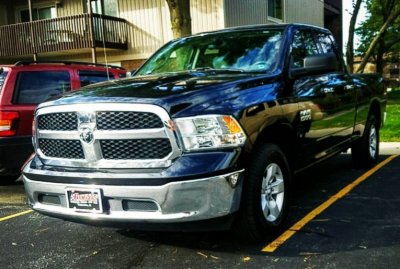

I have a 2016 SLT quad cab.... im trying to figure out where the heck i can add LED pod lights to my truck... I am not opposed to cutting into my bumper but i want it to look clean. I do not have the bumper with the "slit" like most of you do that allows a 32" lightbar to be placed inside of it. I do not have factory fog lights so i want to add LED pod lights for my light up front. The small spot where tow hooks go is where i would like to put them but im not sure how i would attach them. I would like to do flush mount 4" pods. The plastic pieces that sit in there have a bevelled edge and would make it difficult to attach. I thought about adding a bracket to the edge of the opening but its flush and doesnt have a lip. Anyone added LED Pod lights to their SLT? I wouldnt be opposed to adding lights to the grille but its not my first choice... ive considered removing the license plate holder and making cut outs right there but i feel it may look odd having the tow hook opening with fog lights in between them... i attached a pic of my truck for convience.
The #1 most important thing is that it HAS to look clean. I see where "factory" fog lights would go but with how curved the bumper is they would not sit right there either.... I have considered just buying a whole new offroad front bumper but im not ready to drop $1000.

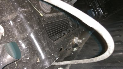

Mine are 9" LED's (they are too bright for driving in traffic). I just used a "big ass" C-clamp to flatten the 90° bend in the original metal work to 45° and drilled a ½" hole
