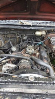

I'm purchasing an 88 dodge ram 150 sc/sb auto with a 318. The guy said the carb is no good. The truck is a long way from my house so I was planning on taking a manifold and carb with me. Any suggestions will be welcome an very helpful on what the best products to purchase.

since it is a 88 with 318 it should be TBI and NOT CARBED. big difference but look the same

^Unless someone converted it over to carb...which might be the case since it doesn't run.

could be but people always confuse the 2 since they do both look similar but there is a huge difference.

Ok if it's tbi it should be easy to convert it tho right just need a fuel pressure regulator?

that is a carb so someone must have converted it. i would wonder if the issue was with the wiring

I dono but it's a 500 mile round trip for me I'd like to see if it'd run before I drug it home. He said it had been running until about 2 months ago

I was wondering that was 88 a cross over year like 1/2 tbi roller 1/2 old school or something?

kind of. 88 was the first year that the 318's were TBI and i am pretty sure it was the first year that roller cams were used. the only engine that stayed carb was the 360 but it was converted to TBI in 89

Does that mean it could possibly be a 360?
