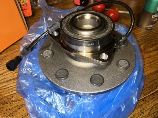

Thanks everyone. The hub is on the way. Really appreciate the help.

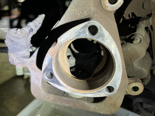

Hey all got the hub bearing, everything apart and getting ready to put back together.
Please excuse the ignorance, but should I put a film of oil on the bearing where it mates to the steering knuckle, or instal dry?
I do intend another cleaning in any case, but it seems dry when I pulled it, and it’s been there since 2004…
Really appreciate all the advice. I know it seems like a really small detail but I’m trying to do it right.

Clean it with some emery cloth, wipe it out, put a very thing film of anti-seize. Should pop right out next time (if there is one).
