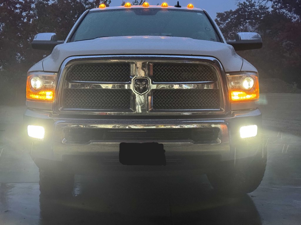

Here you are. I'm pretty sure both headlights and fogs are LEDs, but it bothers me that the LEDs are still a warm/amber color versus the 5000K color which is what I prefer.

Yikes! That does look pretty bad.
The projectors look to me like they are leds you can see the split beam from the led boards when you look at the housing. Looks like they are clocked a 3 & 9 oclock and there's a shadow at 12 and 6.
If that's the case, classic example of why not to put leds in a projector housing. Projectors are designed for 360 degree light output like a bulb or Hid.
I'd put some Hid low beams in it. The factory housing with hids are awesome from what I've seen. I have quad reflectors myself so I don't have first hand experience with the projectors. But I've wanted a set for years.

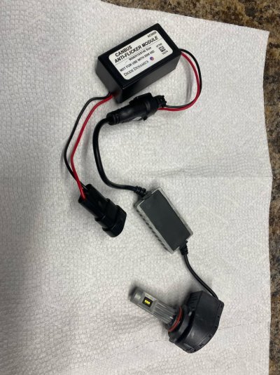

I purchased these HID bulbs from Amazon but I'm not sure if they will work:
Below are images of both the LEDs that were in the projector housing and the HID ones I purchased. There are extra wires on the HIDs, so I'm assuming I'm going to have to throw a bunch of $$ on ballasts?
If that's the case, wouldn't I be better off spending the money on new housings all together if I want to have LEDs?
For HID bulbs you need ballast and possibly relay harnesses.
If you want LED headlights your probably better off buying housing made with LEDs built in

Those Diode Dynamics LEDs are not cheap. I'm not sure why those were ever recommended for projector housings though. I tried that back in 2016 with similar shaped XenonDepot LEDs. Expensive and did not improve light output over stock halogens.
There was a member who said these Sealight LEDs work great in the OEM projector housings because they have a 360 degree light pattern (similar to a halogen or HID).
Amazon
I can't speak to that, but I can say LEDs like the ones pictured above from DD are only good in reflector housings and they also need to be clocked correctly. Any LED that is shaped like that should not be used in projectors. Here is the thread with the pics - https://www.ramforum.com/threads/2015-ram-sport-headlight-replacement.205318/
As for HIDs, I ran XenonDepot ballasts and Morimoto bulbs for 6+ years without issue. Now I'm running Osram Xenarc bulbs which are much more expensive but are a whiter light. I'd still be happy with the Morimoto 5500K bulbs.
If you go with HID, you can either reuse those Diode Dynamic canbus adapters, or you can set your headlamps to HID in AlfaOBD and not use those adapters. Whether or not you need the relay harness, I'm not sure about 2015 models. I would try it first without it.
One final word, you can easily get 5 years from an HID bulb. It's unclear if you will get that from these LEDs with built-in fans.
