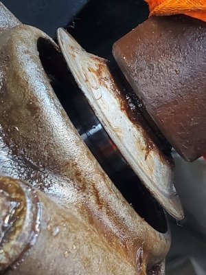

I have found numerous sites saying this is the right side stub shaft I need. It is he one I have. But the diagram above obviously shows otherwise.

Are you talking about the passenger side? If so I also had this issue and after 2 different dealers determined that only the driver side is serviceable in the 13+ rams my whole front axle was replaced under warranty. I only had 61000klm on my 13

Yes the passenger side. The part I put a picture up of is what napa told me was the right one. After looking on websites some also say the same thing. But it's completely different. I have to buy the whole assembly. Even used parts only sell the whole unit. Seems like a good idea for the manufacturer but for the consumer like me or you were left to buy a whole bunch of parts we don't need for just that small part.

That part you put up is for the driver side, pre 13 models both sides were replaceable
Yes I know. what I'm saying is napa and also other major auto part company's claim the two are the same.
If you go on carid it's there as well. Lists this exact part saying front left and right.
im just writing this for future people who google this issue. Hopefully nobody makes the same mistake as me.

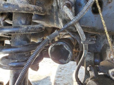

I went to change my driverside cv axle on my 2016, outer joint let go. As i'm pushing and pulling, i pulled the cv out of the inner joint. I start hitting and prying, and started to pop the stub shaft out. ‍♂️♂️. I stopped to re-assess, as i never had this problem on any of my older vehicles. Looks like i'm ordering a new stub shaft and diff fluid, and swap it all out and slap in a new stub shaft with the new axle.
