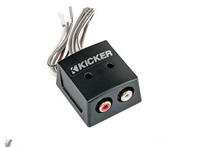

I know this question has been asked several times but I was hoping for some help. I have a 2015 Ram with the 5 inch uconnect touchscreen and the 6 speaker system. I'm wanting to install my line out converter so I can hook up my subs anybody have any step by step instructions on how to do so for the line out converter. Like where do I get power for it and what location do I tap into 20190326_171624.jpg

Which amp you using, some can handle speaker level input, so no LOC needed.

If you use the high-level inputs, tap the rear speaker wires (you can find those in the B-pillars). Run your power all the way to battery via the empty clutch plate in firewall. Run a short, clean ground. Hopefully your amp will automatically sense the signal, so you do not need a remote turn-on?

The line out converter I got in the mail today from kicker it's a two channel with two sets of speaker wires on it and a ground
