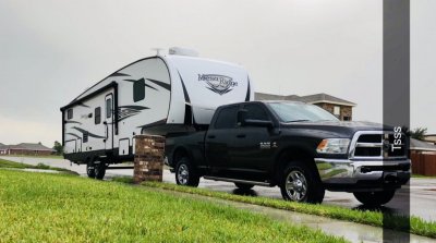

That’s what it looks like, right now is not as bad as we adjusted the king pin and the 5th wheel hitch but still not level.

It's always hard to tell from a picture but I just don't see you getting level with that trailer? The truck would be bottomed out (or not enough travel left) before you could get close to level.
What about taller tires on the trailer? Not sure how much room you have to do that or if it would cause other issues with the trailer?
Yea someone pointed that at the Rv place to get larger tires there’s space there to do it, but after all the info I read amd seeing that is not as easy as I believed it would be I’m thinking I might have to end up trading the Rv lol, the guys at the Rv place told me it was more
Of an eye sore since the Rv has some kind of component on the leaf spring that help to put the load on both axels more even but it’s on my head that I want to see it level
