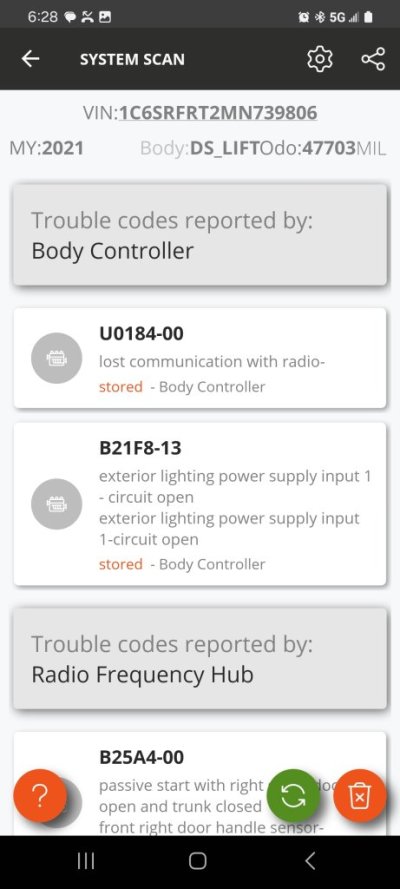

Jimmy07
Feb 23, 2017
3,506
3,544
That B25A4 fault in the radio frequency hub is the relevant one for your issue. It usually means the magnet is missing from the cap.
The door handles are two pieces- the handle itself, and the “cap” that the handle pulls away from when you pull on the handle.
When you swapped door handles to verify the issue, did you also swap the caps from side to side too?

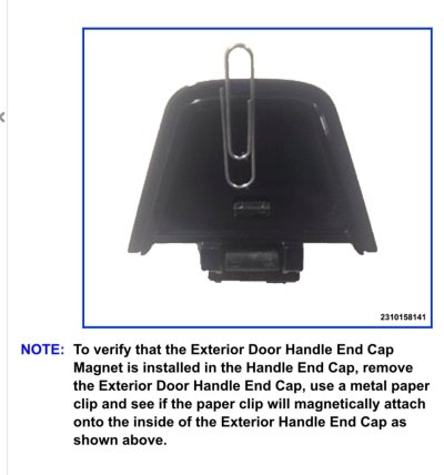

Boom! Took off end cap and paper clip did not stick. Swapped with the cap from driver side door and the passive entry worked. Conversely put cap originally on passenger side onto driver side and it did not work.
So, definitely the magnet on the cap from the passenger side handle is the culprit.
Is there a specific "cap" I can purchase or so I need to purchase a complete new handle assembly?
The cap on the right is from the driver side and works as it should. The cap on the left is the defective one.
View attachment 563985View attachment 563986
