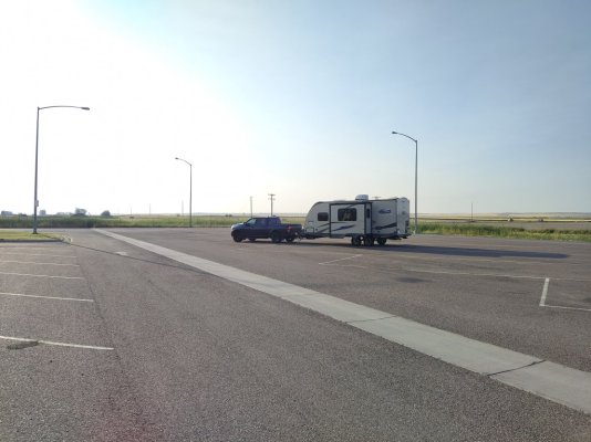

Knock at least $5k off that stick and tin unit. Check the date codes on the tires and have them replaced at their cost if they’re a day over 5 yrs old. Have them bring out a 12’ ladder and check all the roof dicor. Check the fresh water tank. If the bottom is bulging down have them replace it on their dime. If you can pop the bearing caps and look at the grease, do that. Test everything inside. Open every drawer. Remove the drawer under the fridge and any screwed on panel and check for evidence of mice. If you don’t understand anything that I typed above or what to look for, bring along someone who does. If you know what to look for and how to play hardball you can negotiate yourself a great deal or find things that will make you run fast from that trailer.
Your 5.7 truck will tow it fine, just get the proper WDH. I’ve got a 21’ classic with the 3.6 and it tows my 223RBS, loaded weight 5500lbs with 930 lbs tongue, just fine. IMG_3966.jpeg
Your 5.7 truck will tow it fine, just get the proper WDH. I’ve got a 21’ classic with the 3.6 and it tows my 223RBS, loaded weight 5500lbs with 930 lbs tongue, just fine. View attachment 553857
Thx I assume your 3.6 has the higher numerical rear which I think is 3.55 for the v6? We looked at the 2017 and didn’t like how dingey inside it was.
