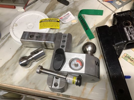

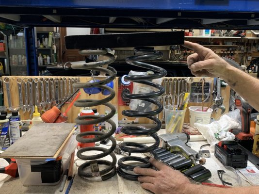

I have a 10k max aluminum trailer which is a lot lighter 2990lbs and a 1500 tradesman. I haul under 4K. No issues with a good hitch and less saggy springs.IMG_1273.jpegIMG_3162.jpeg

I see a few people talking about timbren or other springs or lt tires... my opinion is if you really need those things the load is too heavy. With a decent and properly adjusted weight distribution hitch sag should not be an issue and the std tires are rated to well over the rear axle rating.
