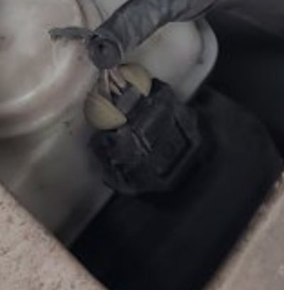

2016 ram 1500 Laramie, can’t get the locking tab off the evap module on fuel tank, any hints?

Push inward (as in making the connection), depress clip, then try to separate. Or try coaxing it off with an appropriately sized/shaped pick while doing the same. Those clips can be a pain and only lack just a "little bit" before separating. Fine line between just enough and too much (breaking the clip). Especially when they've been through a million hot/cold cycles over the years.
