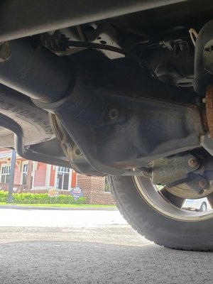

Right near the drive shaft on the passenger side of 2012 Ram 9.25" differential housing
There is a threaded plug, if you take notice, that plug is on the same level as the axle tubes that extend out to wheels.
That is done so that a bit of lubricant is getting to the axle bearings most of the time.
( back around 2009 - 2012, Chrysler made a mistake & had the Fill Plug too low in the Carrier assembly housing
When they realized their mistake, they put out a recall on the Differential Covers, the new covers had a hole drilled them at the level that would allow fluid to bath the wheel bearings & rubber plugs were used to fill the new hole )
Meanwhile, Chrysler put out the word to dealerships & customers that the fluid level was too low & that there was a chance bearings were not getting lubed.
The fix was to remove the vent in the drivers side axle tube & add differential fluid through the vent, they gave the amount of fluid that should be needed.

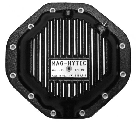

with both of the Rams i have owned, a 2009 & 2016 Ram 1500s
i wanted a differential cover that was easy to service, so i had the Mag Hytec covers installed
Dipstick makes checking fluid level a breeze
Dodge #D 12-9.25​
Dodge #D 12-9.25​

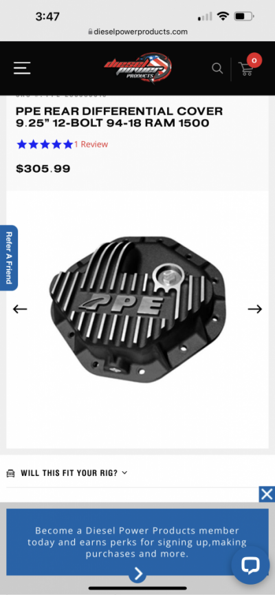

I went with a PPE cover. Has a reservoir type lower but a curved portion for the rind gear like factory.
