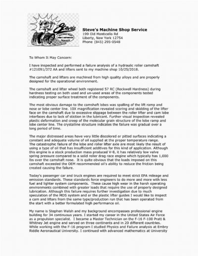

And here is the how the lifter bores are oiled. This is plenty of oil for the bores and debunks Uncle tony's theory as far as the "scuffs" on the sides of the lifters.
The lifters get some oil all of the time and from 3 different sources - lifter oil galley (MDS galley), down through the push rods, splash/mist from the spinning crank/rod/piston assemblies.
"When the MDS solenoids are in the "off" state (8-cylinder mode), they supply oil pressure of approximately 3 psi to the lifter bores. This lifter oil keeps the bores lubricated and prevents air from entering the system. When the solenoids are activated, oil pressure of 16 psi or greater is supplied to the lifters and the engine enters the 4-cylinder mode."

Ran across this today and found it interesting. Apparently this guy does a lot of YT presentations and is well known. Does he have a valid point on why some hemis eat cams & lifters?

Thanks for posting that brother, people that bash him don't get that the jist of what he says is 100% accurate. Maybe he missed some stuff, but when you view 30 lifters and you can see there are lubrication issues, the **** aint getting oil. It is either simply not getting oil, or the oil that hits the lifters is inadequate to keep the lifter lifting.
It seams like lubrication strategies can at least help this issue, especially when added to the posts found by jetblackram. This guy has been building engines for decades and is an engineer. The elusive "expert" needed to weigh in on this issue has been found. If you don't believe uncle tony, and you don't believe ram forum members experiences in the tick threads, then maybe you will believe the expert below. All roads lead to the same location, all three opinions and experiences above all validate each other.
