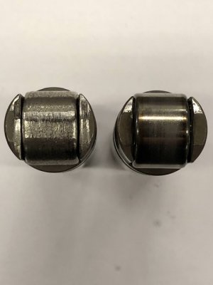

I’ll have to look next time we have one in the shop. Most of the time though the roller is seized and ground down. Usually if there’s any damage on the sides of the roller it’s because the roller was ground down so far that the cam lobe was now contacting the side of the roller. I know I’ve heard people say the lifters rotate sideways in the bore sometimes but I’ve yet to see that happen. Usually looks like this.

Maybe the scuffs in the bore are because of the roller being seized and the cam lobe hitting it with unequal pressure causing it to scrub in the bore, how are the lifters with undamaged rollers, and I agree more research that needs to be documented.

Maybe the scuffs are because of the lifter moving in the same direction under the same force for millions of times.
He never saw that in old engines because the lifters rotated.
I would expect to see a shiny spot on the thrust side.
