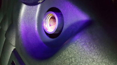

So did an oil change a couple of days ago nothing out of the ordinary , just noticed red paint or something on my hands . Figured it was opening the bottles of oil or handling tools etc.

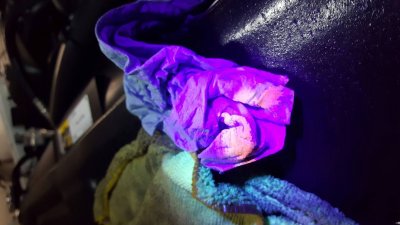

Today , checking oil dipstick level and noticed a discoloration inside the oil filler cap. Wiped the neck of the oil filler cap and blue paper towel came out red. Got my UV light out and the dam thing glowed. ****** LOL.
Remembered on Wednesday prior to my oil change that I did a couple of days ago the dealership stated that they added dye as I mentioned drip from tranny , advisor said they added dye to tranny. Obviously not!

You probably have the 8 speed tranny and it has no dipstick or fill tube. The dye was added to your engine oil. Ask the dealer to show you how they added the dye.

The advisor said they added dye to the tranny. But I'm sure he meant to say engine as it's in the engine. Lol.
I did find it odd that they would add dye to the tranny since the stock 8hp70 has dye already in the fluid from factory from what I've read.
The tech probably thinks it's engine oil drip which I know it is not. Since my engine oil was black and the leak is light yellow gold colored. Now unsure as to whether to tell them to re add dye as I removed most of it by the engine oil change I did .

They might has also checked for an engine rear main seal leak.
