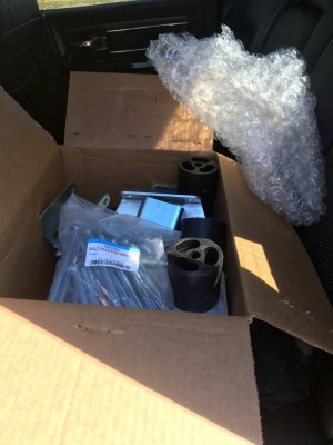

Hey hey, see what was in the mail!

Body lift? Have fun!
Yep
PA 3 inch, on top of bils at 2.1
Nothing in the back yet but might put a 3/4 spacer it is like a 1/8 nose high for now
I did a RC 1.25 inch on my 2011 and was kind of easy, i figure the 3 inch will be similar..
Have to find the time to do it now...

I took out a zone 1.5 and put in the PA 3" . The three was actually easier to install. Less drilling , steering spacer that the 1.5 didn't have is a piece of cake just take time . Rear bumper is also a little easier and stouter brackets than the 1.5. Well worth going straight to a 3" . I was able to lower the Bilsteins back to 1.4 so the shock absorbers actually absorb even the smaller bumps instead of transmitting them. Gave my SB RC a little rake but it was worth it for the improved ride. With E rated 12.50-35-20s I need a little softer suspension to compensate till I decide on what 17" I want . Looks like a 4x4 now

Awesome keep us posted with pics. I've seen other posts here with the 3in PA and bils, really nice look.

I'd love to do a body lift, but the tow hooks make it difficult on my Rebel
