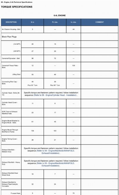

Now for a basic question. I can't seem to locate the torque spec for the oil drain bolt for a 6.4. Who knows it?
I'm sure y'all know and are laughing at this. I used to never torque ****. I also used to snap bolts and pull threads. You know, I'll just give it a little more snuzz. Oops! So now I'm **** about that stuff.

Hello, and welcome to the forum. I think you're gonna love this (it doesn't have the oil drain bolt spec which IIRC is around 18-20 ftlb, but it's good for reference if you want to torque stuff up). https://www.ramforum.com/threads/chassis-torque-specs.92967/

Welcome!! Honestly, just snug the bolt up and you’re good. It’s probably about 10-20 ft/lbs which is just passed hand tight. Don’t wrench it down hard because you will strip it out easily and there’s no point in it. I’ve been working on cars professionally and on the side since 96 and I’ve seen too many people try to become Hercules with it only to damage their oil pan. I’ve always just gotten the bolt finger tight and then put 2 fingers on a small wrench and tightened it maybe 1-2 more turns. Whatever it takes to just put a little pressure with those 2 fingers and I’ve never had a leak or a stripped out oil pan or bolt.

I had asked my FCA Tech that same question when I owned a 2014 6.4L 2500. His response what "gudentite". Huh??? He laughed and said "good and tight". OMG. He is a goof sometimes but he's good at what he does.
He went on to say his FSM said 20 lb-ft for the oil drain pan.

LOL, 20 lbs on drain bolt is common standard, but I would not go past 25 F/lbs.
