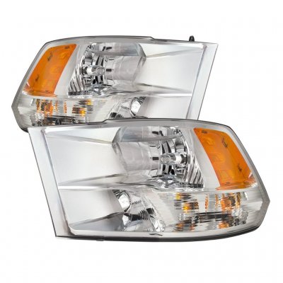

What I am asking is about the configuration of the headlight lens.
This is a projector:
This is a quad:

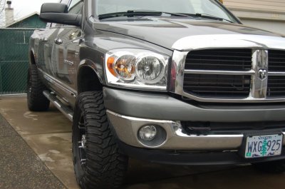

HID light reacts to being reflected differently than when used in a projector headlight. I ran into some problems with my 2007 Ram. I tried HIDs in the stock reflector headlights and it worked OK but the light was so dispersed that having adequate light at a distance was a problem. I also got flashed a lot by oncoming drivers and got the bright backup lights on the back of semi trucks lit up on me more than a few times. Hell, a really good friend of mine called me one night as we were headed back from Cali to Orygun and cussed me out. He was in front of me. Then he demanded I pull in front of him for the rest of the night driving. :D
So I retrofitted a pair of stock headlights with some projector parts:
Before:

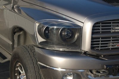

After the retrofit:
The projectors had a great cutoff and fantastic light out to distance. Oh and I experienced no more pissed off friends.
