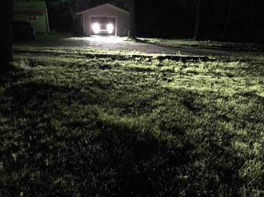

You will not getting anywhere near the light output from led that you will from hid. Led is brighter in appearance but hid reaches way farther. I have led fogs and 50w morimoto hids in my projectors and I was mind blown at how bright they were. Pictures don't do it justice. But here's low beam. 36e2673a9be08d7a6075a5dcc8fcbaa8.jpg
Here's high beam 33a4318ba48901e434cdd7874daf91af.jpg5c319f86d241a7bbd185876f84be251b.jpga512f3b5a6879f314d74ed6bf26f693e.jpg

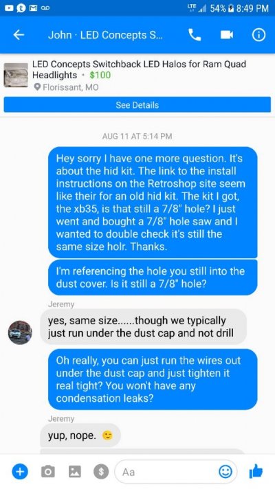

This is so far from the truth. I am building a set of custom 13+ projectors and they are done being built and I've already tested them on my truck. They are finally being installed for good tomorrow.
While doing the build, I asked Jeremy questions about drilling into the dust cap. He answered them, but told me that they (him and his company RetroShop) do not drill the covers anymore and simply run the wires out the bottom of the cap and just tighten the screws. As I did not want to drill into my cap, I did what he said and they fit along the seal and there is no gap or opening.
So no, you don't HAVE to drill into the dust caps, it's not the only way.
Straight from the mouth (or keyboard) of the one guy who knows a thing or two about these projector headlights:
So there ya have it. And id take his advice on headlights and how-to install/run wires over anyone else on this forum.

I've thought about that, but over time I see it becoming a problem when the wires and seal get old the wires getting hot and cold expanding and contracting. Then cold and hot weather. I don't have to be an expert on lights to feel like that's risky business. I too did not want to drill the hole. But I did. I inserted the rubber grommet which was a nice tight fit. Then got high heat gasket maker and sealed inside of the cover and outside of the cover. Think that is a much safer and fool proof option.
OnSale
5th Gen Crew
Nov 12, 2016
3,218
1,730
Philadelphia, Pa
I can see arguments for both sides, but Jeremy has made a couple hundred, if not over a thousand, sets of these oem projectors so if he thinks it's good enough that way, I'll take my chances.

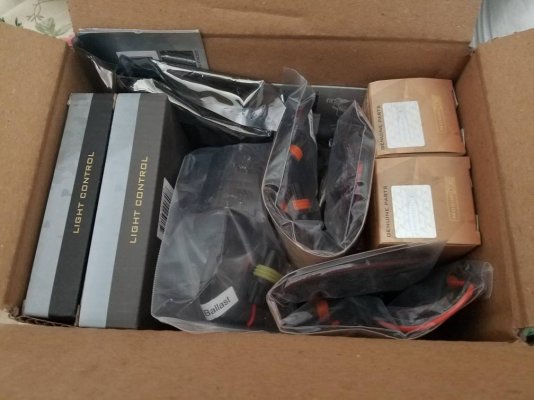

Here is my Morimoto XB35 9012 6500K HID Kit from RetroShop. 672734f3c0177298fb558b6274118c36.jpg1adcfdbf70a4927e00d7eb52b0d25e05.jpg61916802d13826e7e492680c98cfbb56.jpg
