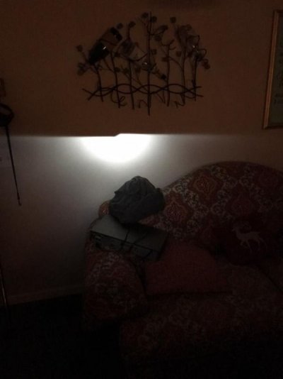

Heres the projectors. I used an LED flashlight to shine light thru to look at the cutoff, bear in mind the HID will be a LOT brighter(and not in my kitchen...)
Thats a hell of a cutoff for a $40 amazon.com projector lol
