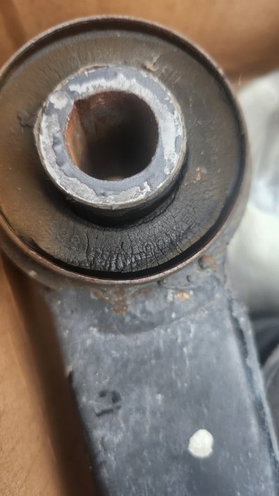

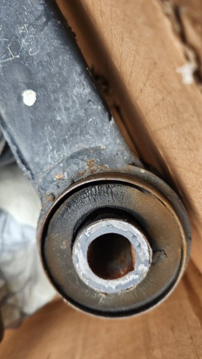

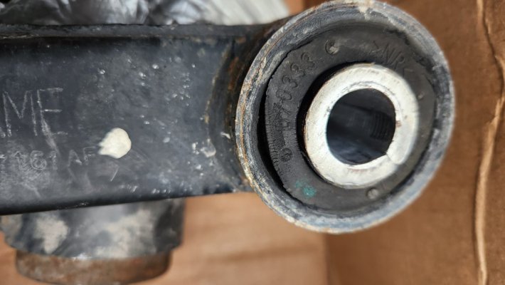

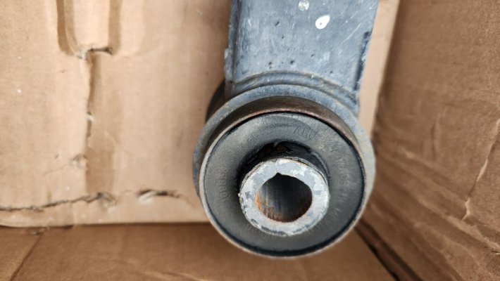

I'm trying to follow up on these threads as I had a similar issue for several years and searched the internet for any solution possible.
This month I finally decided to do the Core 4x4 upper and lower rear control arms cause it was the last thing I needed to do to beef up the rear end.
Well I installed them 2 weekends ago... Vibration gone and this is with the craptastic OEM Goodyear tires on there. I have a few pics that I will post up of the OEM control arm bushing that were shot!!
Only 56k miles. I bought it used back in 2020 with 40k miles so no history of it before that.
