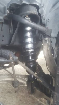

Well got home to a gift from brown santa [emoji41].
Someone somewhere along the delivery routes wasn't to happy about the weight of the package cuz both coils are chipped pretty good. I touched it up since it's superficial and these things won't stay pretty long, but people are douches.
Anyway....pictures and specs
1" factory preload
22 3/4" long extended
I'm working some wild hours again so I'm gonna try and get these installed somewhere in the mix of the chaos. Still waiting on the Old Man Emu coils but that's not a huge deal and will give me a good idea of what each swap does. 20210209_201001.jpg20210209_200726.jpg20210209_200852.jpg20210209_200920.jpg

Damn. You got lucky you didn’t have to wait for them to be built :) that was fast.
Cool thing to see they're also extended travel just like King and Fox 2.5
Count the number of open threads at the top of the collar. If they’re even, turn the driver side 2 full turns up. Contact Icon and see how many turns you need to go up one inch. With kings that would be 5 so every full turn is .2
In my Tacos with Icons every 1 full turn was 1/8, so I needed 2 full turns for 1/4” lift. Max on the Taco was 2-2.1” tops on the preload. But all apps are different. Icon should give you the values you need in yours so you don’t go past max preload.
You want that extra 1/4" on the on your driver front to account for the gas tank lean.

Yea Nick has a TON in stock so these were shipped immediately. Super stoked. It's honestly not a fair comparison to the 6112s. The bodies are obviously similar in size, but these are for sure a step up.
I'll get a count tonight on threads, but I'm pretty sure you're 100% with these being a 1/8" per full rotation. I'm not gonna mess with them initially, since im not sure when my OME coils are coming. When I swap the rear coils I'll decide is I'm gonna dial it up in the front or trim the rear drivers up again. Should give me some miles to break these Icons in and see how much they settle under the diesel.
Even with the 1/4" thick 1/2" front lift spacers I'm only measuring 2.25" over my buddies stock truck. I'm gonna try and get better more precise numbers when we do the install on his. He doesn't want much lift so the 2" or less these will give him might make him happy. I'm pretty sure I've pretty much nuked these 6112s but he drives like 1/5th of the miles I do and it's all road so we'll see.
I'm hoping I can get this in this weekend. My work schedule is fly by wire so I have no idea. I'm only home to sleep right now, have to afford my ridiculous hobbies somehow!

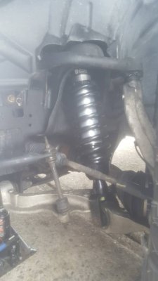

Sooooo in a spur the moment move I got the icons installed. With work and weather being so ridiculous i wanted to get them in so I said eff it and went to town.
Now.....i suck and didn't take any measurements to compare. But I will. Promises. Initial assumption is about 2" of lift. Maybe a little less, but it's hard to say. Angles look a bit better, which is weird, but again I was more inclined to get it together and I wasn't really taking notes. I will say, there's a mile of droop compared to the 6112s.....like I maxxed my floor Jack under the crossmember and could barely get my tire on, so easily an inch over the 6112s. To be continued there.
I did drive it really quick just to settle the suspension in but not enough to really tell anything. Overall they feel alot different than the 6112s in that the damping is much heavier. Not harsh at all, just "firm" like a sports car.
I'm hoping to log some decent miles before I really mess with anything, I want to make sure these are good and broken in and I have the rear setup done before I make any significant changes to height. With the performance comes compromises and I'm more focused on keeping quality split in bump vs droop travel over just cranking them to the sky.
Pics and specs to come tomorrow.....i know.....boringgggg

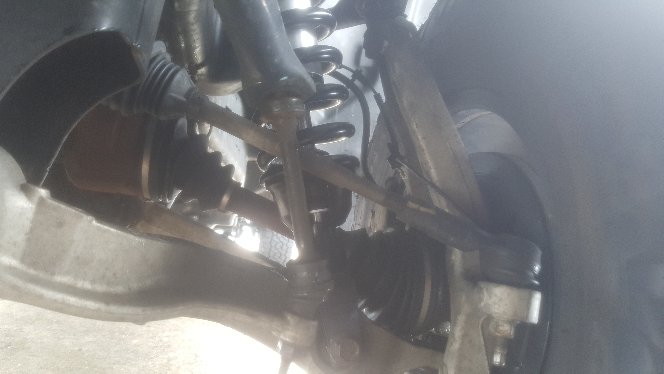

@ram1500rsm here's those specs I promised you
22.75"-front
24.5" rear
26.375" front at full droop
11 threads visible on coilover
1" from collar to top of shock body
First pic is ride height, second is at full droop.

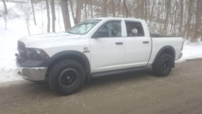

Took the dog and went for a ride. Found the bumpiest road local and "tested" the icons out. Much different over deep potholes and washouts. Never once do they feel harsh either which is awesome. Hard to explain the difference, they feel very similar to the 6112s, but you can feel the difference in valving once you hit stuff harder, so it's the "same but different" in a way, IE less "oh ****" when you hit a hole or big bump. At least using my finely tuned "butt-o-meter".
For now I'm pretty happy with the stance and until I get my new rear coils in I'm gonna leave it alone. Once I add the rear drawers and weight I'll make the decision on the final rake it has. I'm hoping to maintain about 1" or so higher in the rear. I do have plans to add bumpers etc, so instead of constantly messing with the coilovers I'm just gonna do all my add ons and adjust/align it once. Plus the ride and angles at this height are really nice so that's something i don't wanna degrade either.
The front bumper gives the illusion it sits really low at some angles, especially with the stock air dam so I really wanna see how things look all done before I start messing with everything. 20210214_120401.jpg20210214_122116.jpg20210214_122229.jpg

First real seat time with new front setup.....coilovers are the cats ass. I can imagine how much better custom valving feels cuz these are GREAT. They feel very similar to my 6112s when I ran those with the small spacer minimal preload combo, but you can feel a huge difference in valving. There's alot of spots that used to hit pretty hard that now barely rattle change in my ash tray.
Hard to convey in words but, I'm stoked!

That looks like one happy pup!
Truck looks great!!
