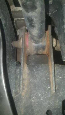

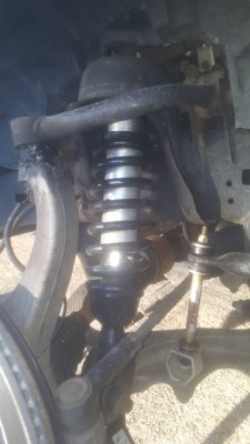

Little photo dump. Needed to update my phone so now it's able to take crappy pics again.
Finally had some nice weather and I'm able to do my spring time checks. Rotated tires, hit things with some lube spray, looked it over and making mental notes.
After about 60k on the UCAs they're starting to look a bit ugly and worn, bj boots are both beat, but until I have degraded performance or issues I have no reason to change them, but they're seeing the effects of 3 winters. Same for rear control arms, I do plan on doing both, but its not a priority. Only thing immediate will likely be panhard/track bar since the stock noodle just plain sucks and id like some adjustability. Otherwise everything seems to be pretty normal, just dirty from winter. As always things are tentative, since I drive so much I need to keep up with maintenance.
152k on truck.
Tires have 12k on them and did my first rotation. Aside from the one that saw some wear from the rear axle bearing going bad I'm super impressed with how little these are wearing. There was a 1/16th "cap" on the main treads and its still in tact on both fronts. I ran the tires a bit high on psi (50) for winter and the rears ran down in the centers a bit. Fronts are lightly feathered, normal for an IFS truck. Dropped them to 42psi cold and I'll see how they like that. They're C rated so they don't feel harsh at higher pressure, I'm just going by what the tire looks like at rotation and adjusting for wear patterns.
Next on the list of things in no particular order is tune, Tazer thingy, and Decked Drawers. I've gotta put a bit of work into the house so as much as I have a list of wants, they're gonna be a bit later this summer. This damn rear axle ate into my fun budget, plus the jeep needs some attention as well. Ideally I'd like to get body lift and bumpers done this summer as well as whatever odds and ends I decide to change.
Super happy with my suspension and aside from fiddling with it, I'm not planning on making any changes.
Anywayyyy enough rambling cuz we all know this **** will change in a few months lol! 20210310_164407.jpg20210310_164422.jpg20210310_170320.jpg20210310_170248.jpg20210310_170153.jpg

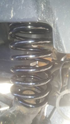

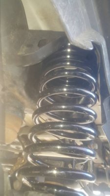

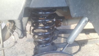

More pics
First tire is condition of fronts
Second is rears
Current stance
And the **** box, because I just can't bring myself to sell it sooooo it's staying. 20210310_170355.jpg20210310_170419.jpg20210310_144126.jpg20201220_134959.jpg

Its crazy how much beefier the aftermarket gladiator springs are compared to ours and we can tow heavier. One of these things the aftermarket for this truck never caught up with. Even the Icons 1.5" look punny besides Claytons/Synergy. You can tell how well the bow looks now compared to the Bilsteins or SLF springs you had before. If they're clacking the Eibach CS5002L insulators should fit just fine. Cut a couple of pieces and slap them in between the death coils. problem solved.
How are the Toyo AT3's doing in the winter for you ?
The bilstein coils had some isolator that I peeled off! So I'm hoping it's enough to get the job done. Looking at your pics it doesn't seem I need much. We'll see, I'm gonna let them clack for a while so the paint will be worn where I need to do them. Thanks for the heads up though, with my luck I'll need more than I have lol.
I was super surprised at how little bow there is to these, literally none. I wish I had a comparison pic of them vs the bilstein coils, it was comical. I can't believe how lightly they sprung our trucks. They do ride a bit like a leaf sprung truck now, but I'm empty and they're in anticipation of added weight. I'm super happy with the suspension upgradesoverall. It's weird cuz the truck feels firm, but eats up rough hits like it's cake. Makes driving this thing fun again!
