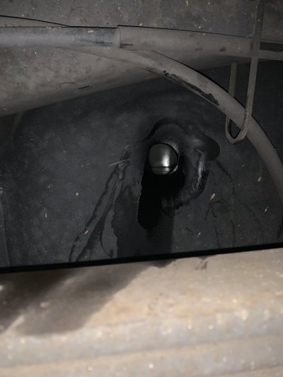

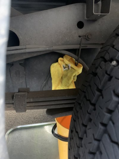

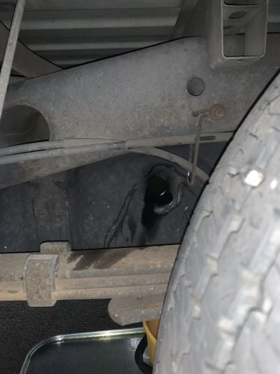

So I was filling up my 2002 Ram 1500 4.7L and noticed what sounded like a waterfall. I checked my gas tank and low and behold there was a perfect circle gushing out gas (I’ll attach pics). I was 13 gal in. I don’t know what to do tbh. Any ideas on what happened? Do I just need to order a plug? If so, what is it called?

Looks like you may have hit by a fuel thief. They use a cordless drill to drill nice round holes and catch the fuel in a bucket. When the price goes up, the thieves get brazen.

Shoot, that’s what I was hoping wasn’t the case. Makes sense tho…gas in Los Angeles is basically worth more than gold.

Definitely a fuel thief. Leave him a lighter and a cigarette next time so you get a new truck.

A thief for sure, not you need a new tank, and hope they don't hit you again..

At first I was like flex tape! But gas would eat right through it. Most patch kits are for tiny cracks. I’m probably just gonna melt some plastic on it and cover it in tank sealer.

Mold plug . An over year it has dry rot, so go dealer web stie see if can order the plug, if not the gas tank.

There is actually someone or "a group" of someones in Los Angeles going around doing this to trucks, especially if they are lifted ... just saw the tiktok video talking about this ...

Most will list crack and hole size, for example Versachem 90180 lists holes up to 1/2" in diameter and cracks up to 5" in length. Not sure what the stick tank is made of polyethylene or polypropylene plastics, which that does not support.
