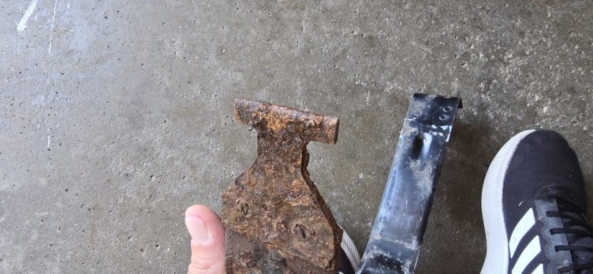

Hey, can you help? I have a 2013 RAM 1500, and my front gas tank strap falls out of the T side hole, because it's rusted out. The strap is intact, but I will replace due to rusty, but the hole on the frame is too rusty to hold it in.
Can you give Me an idea on what to do to fix this? My neighbor suggested j b weld, but I don't know...

Go see your dealer,there was a recall fix for the earlier trucks,that might apply to your truck.
Rusted all to he'll, and your neighbor suggests.....JB weld......to hold your fuel tank up......do me a favor and high five your neighbor with a frying pan for me.
With a recall being issued, 100% take it to the dealer. Had there NOT been a recall, I would be using a welder and large bolts. JB weld...UUUGGHHH.

Here's more info on the recall. You should be covered being in Ohio. But.... the recall does say 2008-2012 tho. There is also a 12year extended warranty for other years. You should be covered.

The extension is for 12 years. Here is the actual letter

After you get the recall done to fix that, drill a hole in the bottom of that pocket and soak it with Fluid Film/Woolwax to help prevent the rust from going any further

Use a ratchet strap underneath as an interim repair. Do not drive it with just 1 strap.

I had same problem w/my 09 Ram 1500, and there's basically 2 options from talking w/others. Have a experienced welder, weld strap solid to frame, there's enough play on strap to connect back onto long bolt on opposing side of gas tank. Or like me I happened to have had a few extra HD tie-straps from where I worked that support 1,000lbs. Only needed 2 of them, there approximately 2-1/2' long, 5/8" wide, and 1/8" thick. Ran it around frame on top of tank and through side beam where it was rusted (top to bottom of it), pushed tank up w/my shoulder and pulled it tight. That's been three (3)years now and still perfect. Good Luck

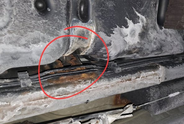

So, the bracket on the frame that holds up the gas tank rusted out and broke on my 2015. My gas tank was hanging down driving on the BQE in Queens. Not ideal situation. Got towed to a Mavis and they tied it up with ratchet straps so I could get back to NJ where I live. Am I in time for this recall?
Thanks,
Tonino
