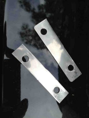

I took an old sheet of aluminum I had, cut it to size and drilled a 5/16 hole on both sides. ImageUploadedByTapatalk1349026865.094592.jpg. This was to accommodate the size of the new horns. Here they are installed. ImageUploadedByTapatalk1349026937.223651.jpg I installed the horns ImageUploadedByTapatalk1349026997.018200.jpg and then I started the wiring. Trying to tap into the battery terminal I broke the bolt so I had to take a trip to the auto parts store. The new one had a bigger bolt and didn't fit threw the cable so I had to expand the cable hole with my Dremel. If you see the pick of the new terminal you'll notice the wing nut, that's how the replacement came. Ram dealership parts dept was already closed. I just got limited to post the next pic since I'm on Tapatalk. To be continued.

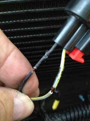

I used looming to make the install clean. I hate a mess under the hood. Once I tied everything down, relays installed I decided to put the stock horns back in. They fit turned around. ImageUploadedByTapatalk1349027533.660036.jpg. I spliced and tinned the wires with a soldering gun so I wasn't removing the original plugs. ImageUploadedByTapatalk1349027592.665624.jpgImageUploadedByTapatalk1349027614.141171.jpg

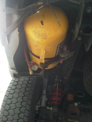

Air horn setup is pretty nice, plus it gives you a reserve tank for low tire top offs, etc. I will take some pics of mine, and post it up, but it is all mounted under the truck/in the engine bay, so no wasted space.
EDIT: Added pics. Also, the tank is strapped as an additional "safety" measure. I welded a bracket on the top that bolts into one of the bed's frame rails, but I figured since I could add a strap, I would. More is always better than less in this case. Also a couple pieces of foam-board between the exhaust hangers, and the tank make it rattle free.

I like the way you mounted the air tank. How would you use the air to fill a tire? Do you have a quick disconnect where you attach an air hose up? Is that what I see near the tank handle?

Ya, there is a T right by the handle that has a quick connect on one side, and the air line to the front on the other. It also sits just high enough, and tight enough behind the wheel well flare inside that it stays pretty clear of road debris from the tires.

Sweet! How many gallons does your tank hold?
