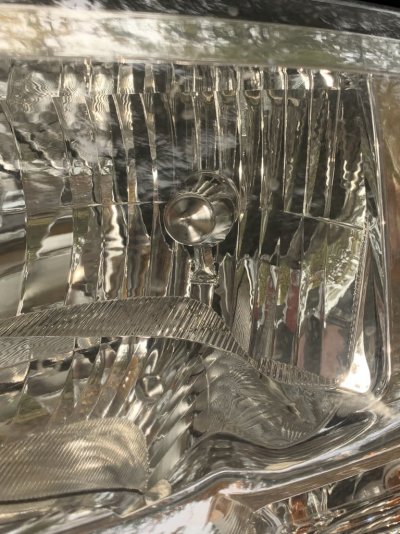

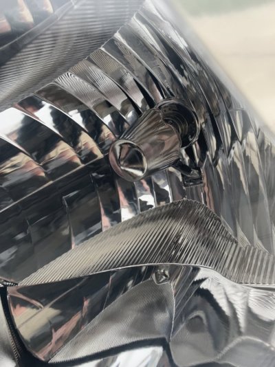

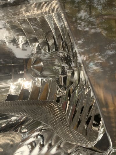

Here’s what mine look like
Those look like the Quad headlights, the OEM ones use H11 bulbs in the low beams and 9005 bulbs in the high beams

Yes those are the base model "Quad" halogen refective housings. projectors always have a round magnifiy lens in front of the bulb. I upgraded from the quads to projectors a few month ago on my 2015. it was a worthwhile update and changes the look of the truck.
