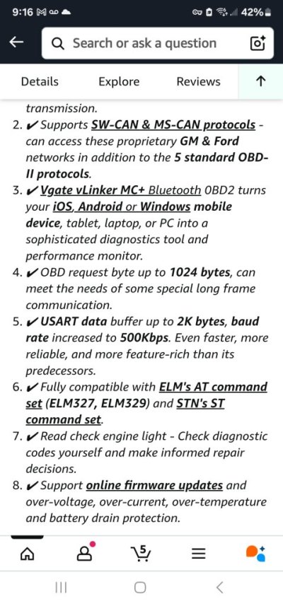

Here's the dongle I use, I've never had a connection issue with this one.

Pretty sure that one is not bi-directional, meaning it can read codes and reset them, but that's about it. To change things, you need the bi directional ones.

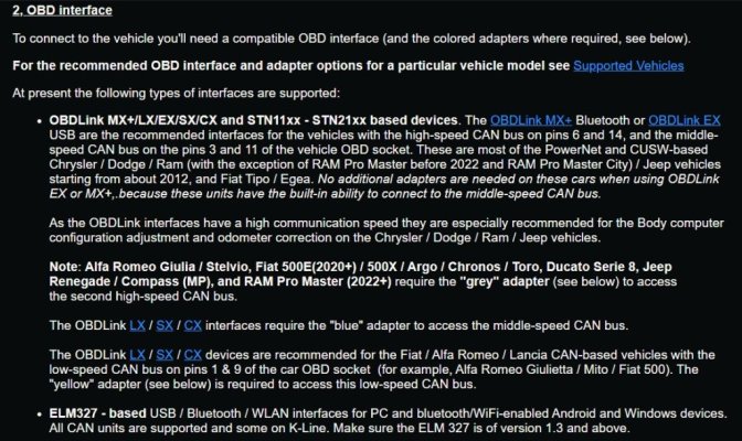

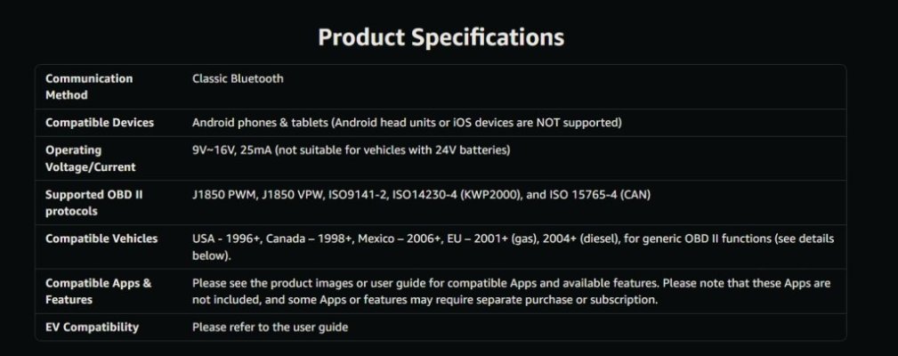

This BT interface does not appear on the AlfaOBD compatibility list.
It may allow limited functions, but AFAIK, it must be capable of the ELM-327 protocol.
AlfaOBD interface details;
VeePeak specs;

As far as I know it will, I've read reviews of people using it with AlfaOBD on Ram trucks.
If you scan the Amazon reviews with a PC, try control F to wordsearch Ram. :cool:
Sometimes these less than ideal devices create more grief than is worth the time, at least for some of us.
It may function well for basic operations but cause grief for some others, but was OK from what I read.
I'm allergic to android devices and even less fond of Bluetooth use with android.
I use windoze with a USB interface. Much cheaper than the MX+ and more reliable, AFAIC. :cool:

Will this work then ? It's ELM 327
Even the super cheap ones are ELM 327 ( I know, I have a few). The ELM327 is the chip needed to read the OBD2 standard engine codes and such. The more sophisticated ones read and access the other modules like brakes, steering and body control and can read and write to the modules (hence the bi-directional), not just read..
