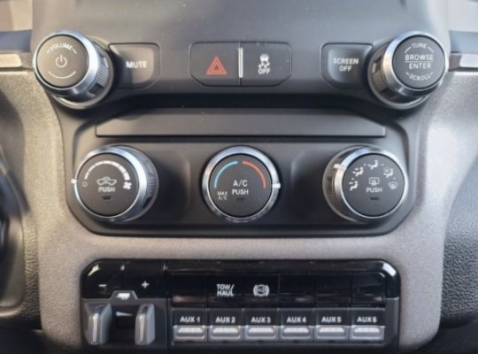

I bought a 2020 Ram 2500 Bighorn and would like to add a few accessories but do not have spare aux switches on dash. What is the best site for replacement aux cluster? Looks like stock aux cluster has room for at least 3 more switches?
It can be done. You would get this lower switch bank to swap in place of yours- 3yRrqc6.jpg
Since you have a diesel, you already have the auxiliary fuse box in the engine bay because it is also used for the cabin duct heaters. You would just need to populate that aux fuse box with the rest of the relays, fuses, and wiring, then enable the switches with AlfaOBD.
