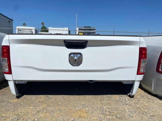

I wonder what the dimensions of newer tailgates are
Could a person fit an older tailgate with manual release into a newer tailgates place ?
Or maybe just switch tailgate handles ??
it looks like a 2018 & a 2024 Ram Tailgate, are the same width & height
60" wide
21.4" tall
60" wide
21.4" tall
When I brought this truck home in Mar 2023, I didn't know before I picked it up that it had an electronic-only lock on the tailgate. I got hold of my salesman and asked him to check and see if I could swap it for a manual, or at least a dual-lock type and told him I'd just buy it if I had to and throw this one away. He checked everywhere for several days and got back to me with a, "Nope, there is no tailgate for your truck other than electronic-only lock."

2024 Ram 2500 Tradesman 4x4 Crew Cab 6'4 Box Truck For Sale Chamblee GA​
under Exterior
Manual Tailgate/Rear Door Lock
So they did have Manual Tailgates
Jimmy07
Feb 23, 2017
3,507
3,548
Wasn't there a Ram 1500 Tradesman built in that year/
They surely would not have Electric Tailgate on those, would they ?
under Exterior
No.
Every single 2019+ Ram 2500-5500 has the electric tailgate release.
Every single 2019+ 5th Generation Ram 1500 (DT body, 6 lug wheels) has the electric tailgate release.
