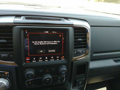

This d@mned "ozone warning for Galveston County" that keeps hogging my U-Connect screen? I've been thru every setting and can't find it. I'm 100 miles from Galveston, even if I was there I still could care less!

I have never seen that. Can you post a picture?

Next time I drive it. I know it'll be there at least once every 10 minutes or so.

This is a reply from another forum but same topic
The weather alerts you are experiencing are a feature of SiriusXM Travel link and unfortunately cannot be disabled. We have passed customer feedback regarding this feature along to Uconnect in the past and will be sure to send this thread over as well. We would recommend reaching out to SiriusXM Customer Care for further assistance!

Here’s a few I received this year

After an hour of Googling, it looks like the only viable solution is to unplug the satellite feed plug from the radio head. Some people on other Dodge (cars) forums are using a "Tazer" with a new update to disable it. Had to look that up, it's a programmer that plugs into the OBDII port. So far, I've sent email complaints to Chrysler Customer Assistance Center and NHTSA concerning the lack of being able to turn this off. I don't feel safe driving and constantly having to click a popup screen that does nothing but... interfere with my driving.

Called the "XM-Guardian" hotline, no help there. Then called the Sirius "General Questions" line (1-877-855-8400) and the guy said to make sure I have the latest update (I do), do a soft reset on the system and if that doesn't work, have the dealer do a hard reset. The latest version is supposed to cut back on the number of alerts, and he couldn't tell me if a future release would allow us to turn it off completely. Maybe if they (and the gov) get enough complaints, there'll eventually be an off button update!
I'll inquire further at the dealer when I go pick up my plates...
