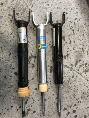

2wd or 4wd? If it is 4wd I believe a set of front struts from a 4th gen might work for about 2” in the front. I attempted to use a set of bilstein 5100 to level a 19 but 19s struts srt a alittle taller. The strut on the right is from a 19 the spring seat sits higher on the strut. I believe a swap the other way would provide a lift on 4th gen
