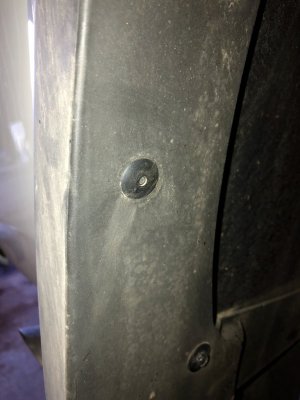

Trying to replace the poor excuse for a mud guard on my 3500....
It has this plastic thing... I don’t wanna yank too hard for fear of damaging the fender flair...
How the hell do you remove it???

Screw head broke off, it’s plastic so drill it down about 1/2”

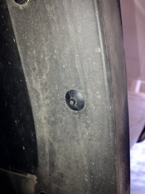

what looks like a screw head is actually plastic... there is one on each mud guard two have the nub sticking out and two are flush.... what is on the "other end" of this - is it all plastic?

I'd slip a cutting knife blade under the edge and saw through it. and replace with original or aftermarket plastic plugs. there's a ton of them available at hardware stores..some that are better than the oem. I like the GM type where you pull up on the head with a screwdriver blade and that frees the base part to just slip out. I just had my door panels off to do the speakers this week and the screw type are for the birds. In a perfect world, tney unscrew and you pull the bottom out. Or they just turn and turn and turn, unless you also put a straight edge underneath the screw part to give the screw some additional leverage against the threads. I had a mix of both in terms of how they came out. mostly the latter.

your going to want new fasteners.....use a plastic fastener removal tool ….it will go under the fastener and lifts it out and will probably break...your new mud guard should come with fasteners if not you can buy online or your dealer ….good luck...ps I have used a fork many times for a removal tool slide the fork underneath the fastener centering the fork so the pin of the fastener slides into middle of fork..

Brilliant on the fork idea....
Thanks!
The new “heavy duty” flap come with metal fasteners and brackets

Yup that’s a plastic rivet. Use a drill the size of ¼. But make sure to hit the center bang on. Don’t go too deep either as u will hit paint.
No screw head, these are plugs, But I am thinking drilling the center out may not be a bad idea, as if you just pry them out they are buggered anyway, Body shop guys here , pipe in. you have to make new plug up of course.

Yep, either way if you try prying that out it may enlarge/distort the liner hole so just remove/drill the center portion that acts like a mandrel and backs up to squeeze the flange.
Rivet is junk anyway, don't compound the damage.

Most auto parts stores carry many different types and sizes of the plastic fasteners. Drill it out.

FYI, Lowes carries a pretty good selection of these and the screw head type. I was actually impressed as they had more than advanced auto on the shelf.
