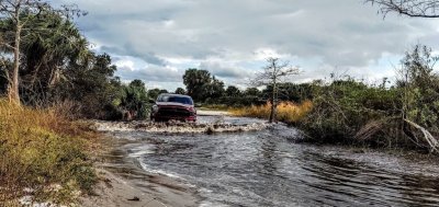

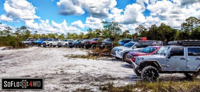

Definitely pretty good but you’d need better tires. I had procomp at sports in the stock size with a 2” level and was going through some decent areas with a group of lifted jeeps, 4 runners and a few land rovers. I didn’t get stuck. I believe that to be the stock lsd. It was a good bit of mud and soft sugar sand. As long as you know what you’re getting into and go prepared. One of the lifted 4 runners on 33s got stuck. Well they framed out... now I’m at 3/1 lift and running 35s and have not had any issues whatsoever. Soft sand or mud are a breeze. I’m definitely needing to look into a trutrac swap now though due to the weight of my wheel and tires. They’re 103lbs per corner vs 75lbs on my procomp setup. I can feel the stock lsd isn’t as happy with these tires. I probably should swap my diff fluid too just to be safe.
Edit: I have taken my truck up to the headlights in water while off-roading and no water intrusion. Just make sure to let everything heat back up to dry out before you shut the vehicle off or you can run into other issues.
This was my 2” level on stock rims and AT sports in the stock size. I can’t find the video of me fording water to the headlights unfortunately.
edit 2: my truck now and also out with the off-road group I join every once in a while. 0E5C3B54-4076-4E7F-B834-B85F005C7A6F.jpeg 20431FF2-9908-457D-A8BA-6163A7832659.jpeg

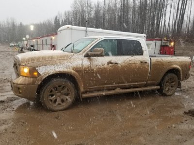

Compared.to my older trucks with normal.transfer cases and none of the traction control or other gizmos it's nowhere near as good. Compared to a prius it's great. As long as you turn traction control off when it gets steep so you don't get slowed to a crawl and stuck and your transfer case doesn't.overheat and shut down the fwd it'll get you most places.20191022_180127.jpg

You have the auto transfer case? The standard transfer case don’t have those problems. They actually have a swap to the regular style transfer case that doesn’t have the auto in them.
Yes I have the auto one. Once the warranty is over I may swap. This one does seem a little better than the one in my 2011 even though they're both bw 44-44 so maybe they're programmed a bit different now. With the traction control off it still applies braking to spinning wheels as it'a not completely of. I had 3.92 and limited slip in both trucks because I never count on the 4wd working if I need it. Also why I have the tow hooks and tire chains.
