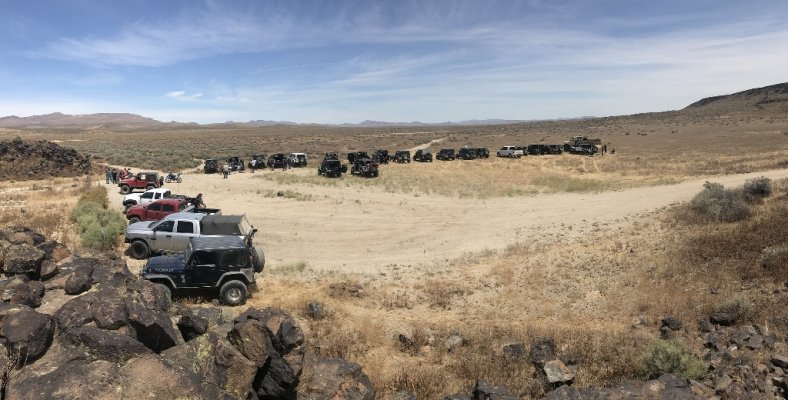

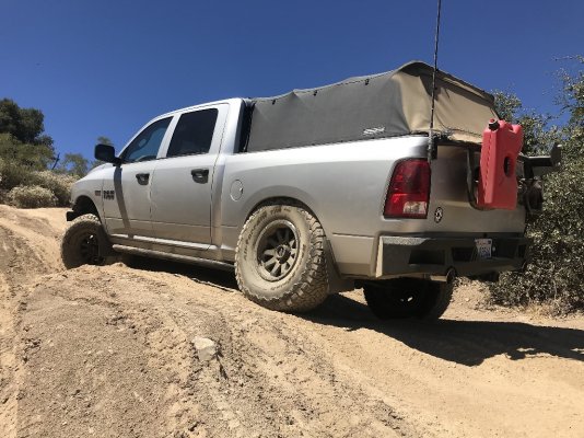

It depends on what you're going to do. i know that recently (few months ago) we had a dude swearing by his auto lock feature and how tight it was locking for him while in 4auto. That sure contradicted a few hundred statements and videos we have around from trucks with the 44-44 :), but in his defense his truck i think was a Classic 19 or 20 i can't remember, so maybe FCA have learned a thing about the 44-44 and how the way they're programming it? Don't know.
In any case we have a member that sells a device that can fix that up. If i had 44-44 tcase that will be my 1st mod no questions asked. Trust me i've seeing that system in action and it sucks when you're expecting the wheels to move and they won't move, won't even spin or only one will spin. never seen anything quite like it except for the little Jeep Renegade.
Regarding stock capability. you can drive in 4x4 everywhere your stock front bumper will allow you to go. stock tires do suck for a lot of conditons and the truck is not advertised as someting designed for adventure. it's just another 4x4 truck on the road but we share the same traction control with Jeeps (Brake locking differentential, not a replacement for a locker just in case) and combined with the factory LSD, the thing can go places and surprise a lot of people if you're not affraid and know to drive offroad.

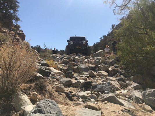

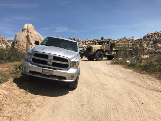

It's a little wide for most rocky trails, though here in the Socal desert we don't have much issues with vehicle sizes and trail space, do you see the mammoth in the right corner here ?, the little silver whale is on the left :)
47825378342_d8ecb66d7c_k.jpgUntitled by RAM RSM, on Flickr
40589853103_2cd4610cec_k.jpgUntitled by RAM RSM, on Flickr

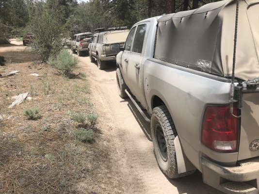

1500's are not rock crawlers, but a little 2" lift with 315's and even on stock bumpers you can go places with little rocks here and there
32613368607_d4890e2121_k.jpgUntitled by RAM RSM, on Flickr

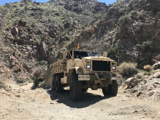

Easier for Goliath of course, you think 1500s are too what for the trail ? wide ? big ? what ?
hahahahahaha
47561032691_7090278462_k.jpgUntitled by RAM RSM, on Flickr

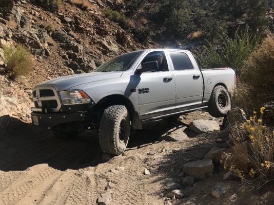

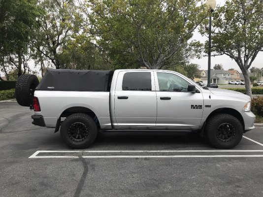

Don't be affraid the truck can go places, not exactly stock though, 2.5" lift on 315's, couple of Mopar skids and rock sliders
33684239678_15399e74a5_b.jpgDSC_0056 by RAM RSM, on Flickr
40799447123_0e4c3488d8_k.jpgUntitled by RAM RSM, on Flickr

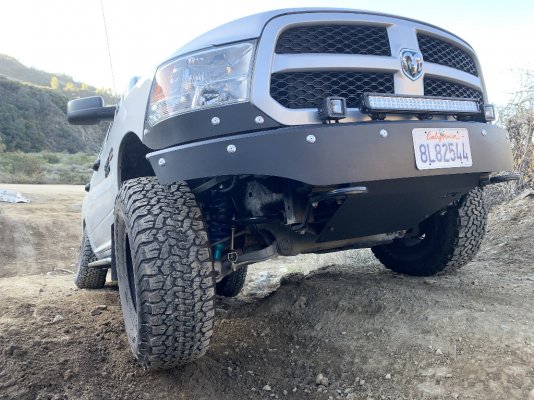

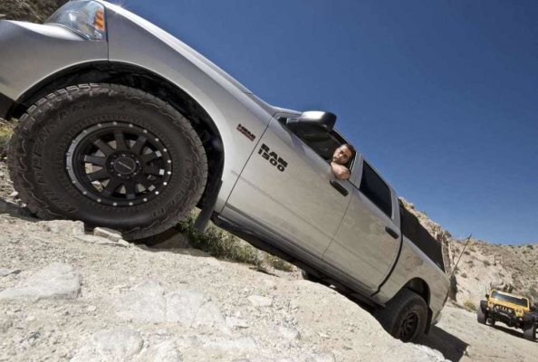

Going to the mall here cause it's just an Express 1500
48156140556_e96b7e2a92_k.jpgUntitled by RAM RSM, on Flickr
48261385016_3ca78ff35c_k.jpgUntitled by RAM RSM, on Flickr
Of course you need 6" of lift to offroad 37's right ? Lol
48390015177_22f593750d_k.jpgUntitled by RAM RSM, on Flickr
48473319266_bfbfd69dae_k.jpgUntitled by RAM RSM, on Flickr
48888591117_a746b4da54_k.jpgUntitled by RAM RSM, on Flickr

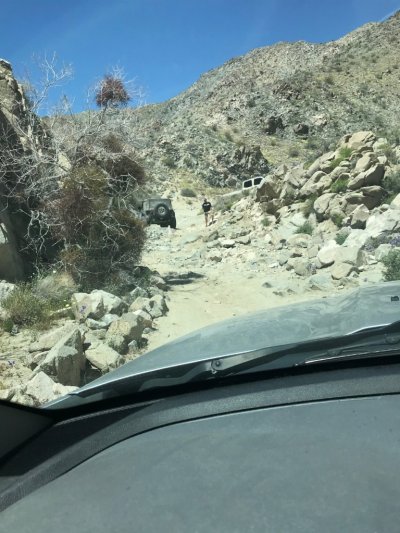

Easy trail for a Jeep
48888614712_3690f719d2_k.jpg by RAM RSM, on Flickr
same thing , easier to navigate with 37's, the Jeep in 37's and my RAM is on 37's. I don't think a stock 1500 with stock tires will make it here. There is no clearance with the factory bumper and ***** sidewall tires will work against you. That is the worst thing i see from a stock RAM 4x4 the front bumper clearance and 20" tires with short sidewalls that will deflate if you show them a little rock. stock GY's are not offroad tires and everything in that line of tires meant more for highway with p rated sidewalls are garbage for anything more than a simple fire road. The factory wheels will work but you want at least some 35's given our big wheelbase with strong LT sidewalls for extra protection if you're doing more aggressive off-road. Not everybody will need 35's you can still have 33s if you have a work truck but ditch the ***** sidewalls if your truck is in the field often. A toothpick will give you a flat with P rated tires.
48888432711_f1608ce06e_k.jpg by RAM RSM, on Flickr
48888437151_609fd9a8d1_k.jpgUntitled by RAM RSM, on Flickr
49223571317_3f5ff2c540_k.jpgUntitled by RAM RSM, on Flickr
49312015123_0a0e507c80_k.jpg2020-01-01_02-32-04 by RAM RSM, on Flickr

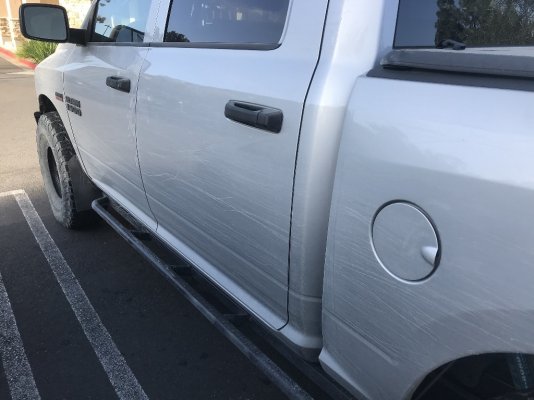

Also remember sometimes you can't go offroading without expecting some damage so don't be affraid of some pin stripping or metal contact or bumper damage. etc. our door panel paint is not that ***** so all this goes mostly away after a wash, prob more if you use waxes and the like. i'm not into that for my trucks or Jeeps, water and soap, then more dust and dirt on top on weekends. lol
48891837947_dab0c62493_k.jpgUntitled by RAM RSM, on Flickr
48887905978_da26aa7920_k.jpgUntitled by RAM RSM, on Flickr
it really depends on what you want to do and how aggresive you want to go, sometimes you can't make that u turn or backup so the only way is forward. We don't have many armor mods and with IFS rock crawling is not exactly this truck forte, they fair a lot better in the open fields with sand,dirt, some mud, snow etc and with the right suspension you can do the same with a lot more speed. The stock LCA's are damn rock solid, mate that with aftermarket HD UCA's and Performance shocks and your front/rear can take some abuse, is not a dune jumper without a proper long travel setup though so thread lightly without it.
All in all, a little lift with real man sidewall tires and some guevos , plus the TC fix in the 44-44, or just a straight 44-45 with 3.92's (though not exactly needed) and this trucks can go many places, add some good shocks and i guarantee you the grin in your face will a be poem for a long time.
Have fun.

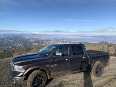

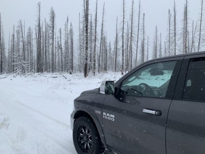

I have a similar set up, crew cab Laramie with 3.92 and limited slip. Spent much of the last two summers exploring the Washington Back Country Discovery Route. Only changed I made was going to Toyo AT 2 tires, all else stock. Truck does fantastic on the eastern slopes of the Cascades. My only issue was I cut one of the stock Goodyear’s up on Umtanum ridge.
There are lots of fun places to explore in Washington with your truck, toss a few tools in the back just in case and have some fun!
