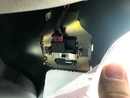

How often do you have to replace the Humidity sensor?
I think it is time for my second one i 8 year of ownership of my 2015 RAM sport.
It is looking like the sensor is still in verions one too " 68440808AA " or have they changed part number completely :hmm:

Same as last time, the climate control does not cool the cabin down on auto and you need to turn the fan on max to cool the cabine down.
Ac system got a service last year and it hade lost 50grams of R1234yf sins 2015
How is the weather in Sweden today? Nothing lasts forever,but I wonder what your issue is based on why you think the sensor is KAputt? Any code?
Maybe your interior has moisture coming in the truck as in a leak,from somewhere?
Winter a round 0°C / 32°F and 20°C / 68°F in summer is Stockholm
I have not checked code this time
I hade a rear window leak 2 years ago, could be that

I could be wrong, but I think they're only in trucks with the auto-A/C
This is correct, it's only in the truck with the Auto Temperature Control
There is also a solar sensor on the dashboard the ATC trucks have
I doubt the AC not cooling the truck is a result of the windshield dew point sensor not working. It's usually the opposite problem where the AC compressor doesn't turn off.
If the 50 gram leak wasn't found, it's probably become worse. That was about a 10% loss of charge probably borderline of effecting performance.

It was the same the first time the Sensor was bad, to hot i cabin ;)
Checking codes are more expensive than replacing the sensor here in Sweden. So ordered a sensor and will be back with results
Edit: the AC machine did not detect any leake during service

When mine went bad, used a Dorman to replace. That didn't work, so replaced that with a Mopar. Still didn't work. Come to find out it was the return (ground) pin on the connector. Repaired it and all is good. Dorman still sitting in the box if anyone wants it.
While it was bad, everything seemed to work OK, except the Auto AC not cycling the the defrost heat and AC to keep the windshield fog free.
Firmly believe that getting something, like window cleaner, in that spot, it messes up the contact area for the sensor and sensor function goes south.

The symptom of a bad one often go unnoticed but it actually causes the A/C compressor to run non-stop when that sensor goes, anytime HVAC is called for (even on max heat).
