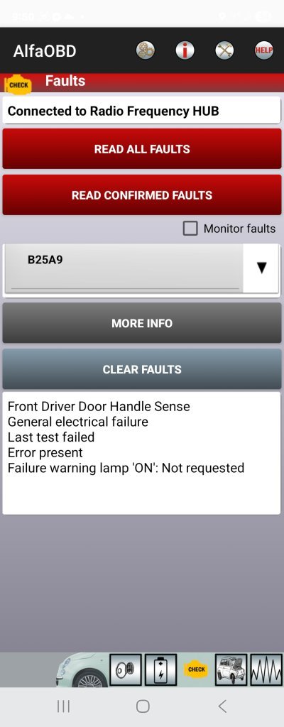

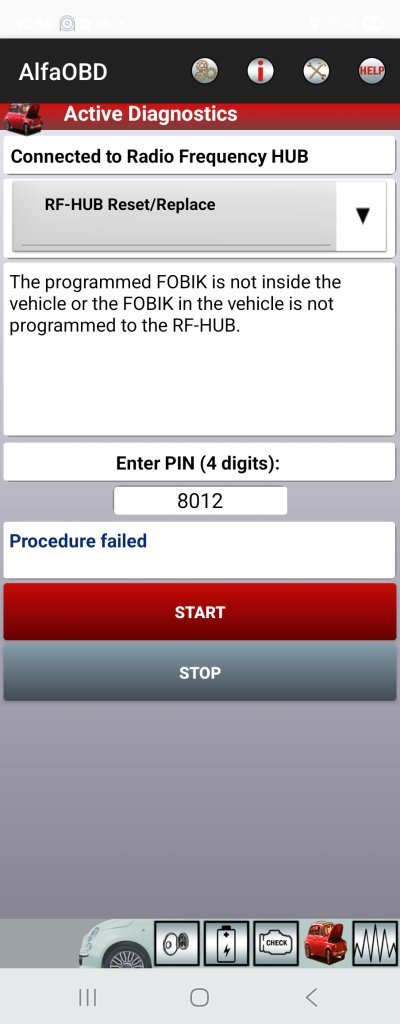

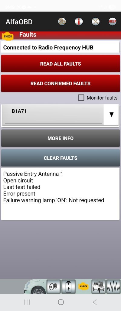

Any ideas i have the original al antenna and its wiring in the back and the one under center console as far as I can tell is wired correctly it programmed 2 keys as the instructions sugested but when I go to the replace hub option it gives this error

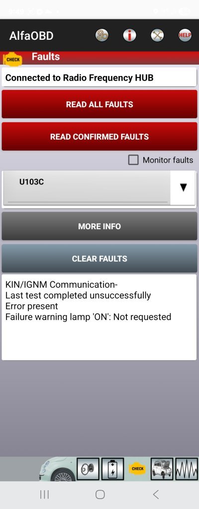

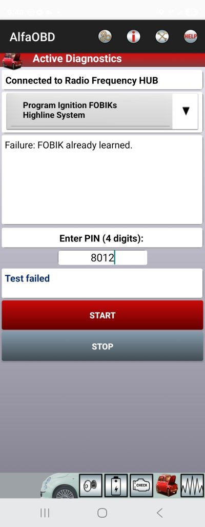

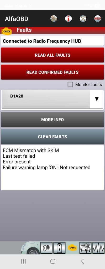

This is error when I try to program key again fobic allready programmed.
antenna 1 and 2 missing to he expected o ly front and rear installed and the door handles missing as well makes sens I did read somewhere about writing the vin to the rf hub but can't see how to do that key lock and unlock the truck and even remote start it but shuts off after 3 seconds
The skim error may be since I scanned codes after putting the regular key module back in instead of the push button
This is error when I try to program key again antenna 1 and 2 missing to he expected o ly front and rear installed and the door handles missing as well makes sens I did read somewhere about writing the vin to the rf hub but can't see how to do that key lock and unlock the truck and even remote start it but shuts off after 3 second

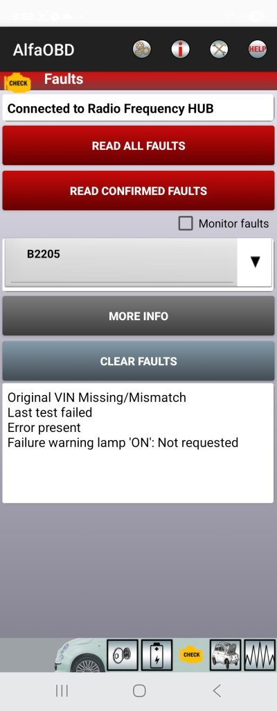

So reading through posts seems I've made the same mistake others have with a junkyard hub I feel like this would be a good note to add to the top @Jimmy07 but I've also read somewhere i can't remember that there is a way to write the cin to a hub am I out 50 bucks for this used hub or is there a way to use it?
EDIT / PSA:
After digging into this (and reading through a lot of user experiences), it looks like there is no practical way to reuse a used RF Hub for this project — or really for any project. Maybe if you had a flooded truck and got everything from a doner with matching vins.
  • Once an RF Hub has been programmed, the VIN is permanently stored in the module.
  • Neither AlfaOBD, JScan, nor even a dealer with Witech can overwrite that VIN.
  • The only “workaround” would be rewriting every other module in the truck to match the used hub’s VIN — which is obviously unrealistic.
  • In theory, you could “virginize” a used hub by flashing a clean EEPROM image, but that requires EEPROM programmers, Chrysler’s internal engineering software (CDA6), and pirated/unsupported tools. That’s not something an average user will have access to, and it carries a big risk of bricking the module anyways.
Bottom line / PSA for anyone finding this thread in the future:
Do not buy a used RF Hub. Always buy a brand-new, ****** RF Hub
if you want this to work correctly.

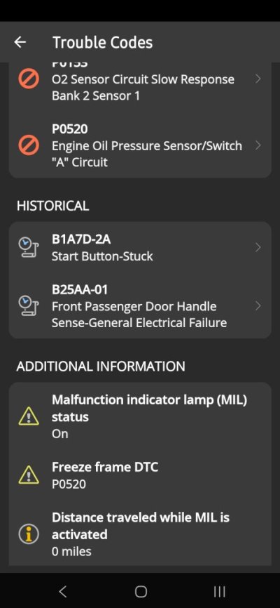

It doesn't work any more touching the key button to the key. It works for a few weeks sometimes and then I get stranded. I replaced my immobilizer box, my shark fin, and I replaced the back wall antenna and it worked a few weeks. Now it really won't start at all. About a day ago it started 1 time

You seem to have a lot of circuit codes it could be the TIPM fuse box. Check make sure no fuses came loose.
should i replace the whole fuse box? i'll do anything at this point i dont have a running vehicle. i checked fuses.. this is the one under the hood?
Based on that first historical code, I would suspect you have a bad ignition switch.
