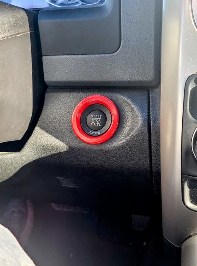

Been busy but just wanted to post my setup I finished a few weeks back only took me 2 days to get it done s/o to @DoughRat19 Very knowledgeable made the process easy20220401_084305~2.jpg
