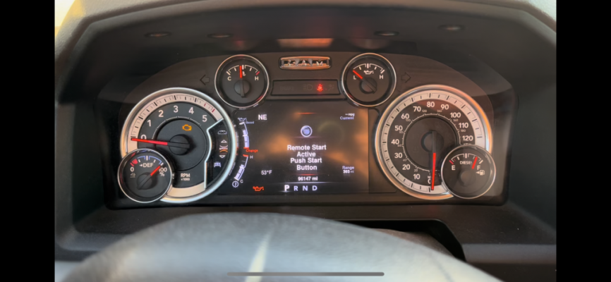

Has anyone done this change over and had problems with their remote start after. My truck acts like it has started but doesn’t. The dash shows started but truck isn’t running. The only I have seen from inside the truck is that a small re blinking I would say security light on speedo is flashing. Made sure all the setting are still correct in Alpha but nothing is wrong.

Should have asked you this the other day. Are you trying to remote start from inside the truck? You have to be outside. Make sure there are no fobs in the truck and all the doors are closed and try to remote start from outside of the truck.

DoughRat19 thanks for all your help and for the amazing wiring harnesses. You are the best and I am glad that you thought about something I accidentally turned on in AlphaOBD. That fixed my issue
