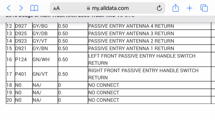

Hello everyone,
I have a 2018 2500 laramie and want to add the rear proximity door handles. Can anyone point me in the right direction on what wires I need to tap into to make them work?
Thanks in advance!

Hello everyone,
Thanks in advance!
You can either pick up the front door wiring right at the rf hub or you could also pick it up from the front door connectors.
