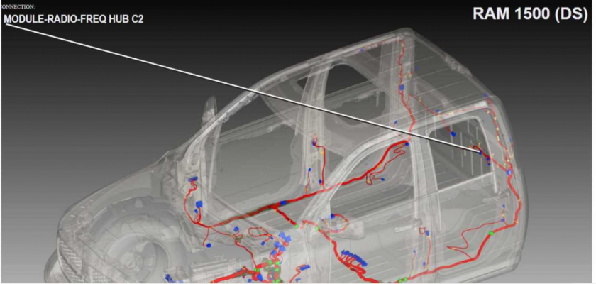

Hi to everyone. I try to find RF hub C2 connector but no luck. Anybody could help me where I can find it?
Thanks!

Called toda to stealer - they told me to buy a kit for 280 CAD - For one piece of plastic and 20 wires. Do any one have any sources? Moser selling them now as a pack of 10 000 pieces.
