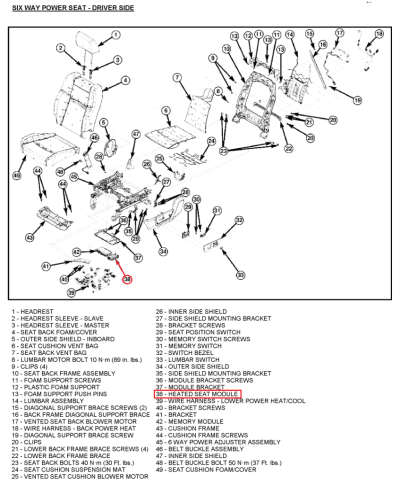

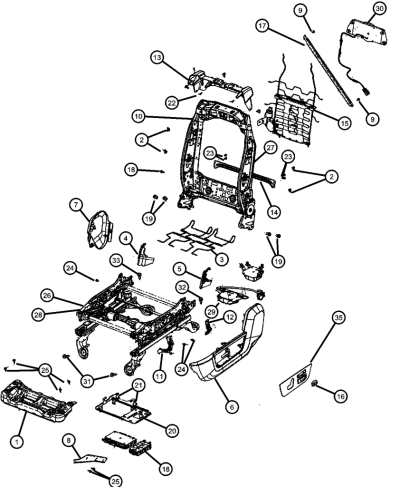

Hello,
it seems that I do not have the bracket for the seat control module installed, item 37 on the sketch.
Can someone please provide me with the part number?
Many thanks

jawzs2
Air Force
Mar 24, 2014
2,925
5,470
South Jersey
2010, 2014
1500, 3500
Try this - 68050610AA, that may be it, my parts list has it marked as #20
20 BRACKET, Seat - 68050610AA

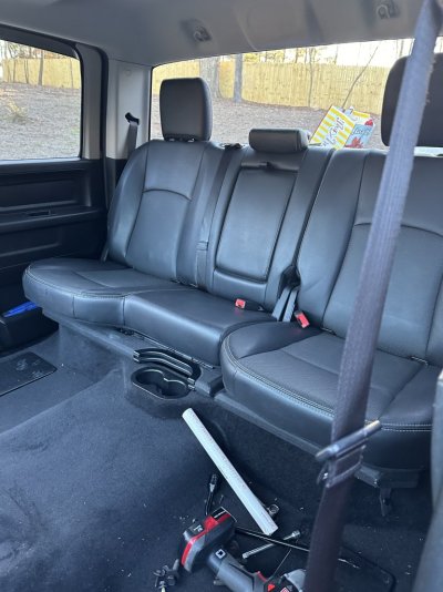

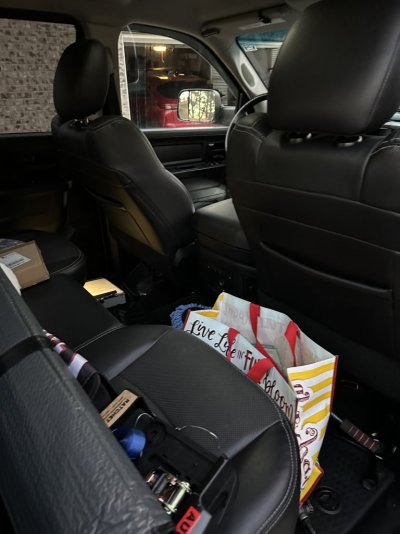

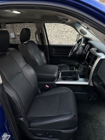

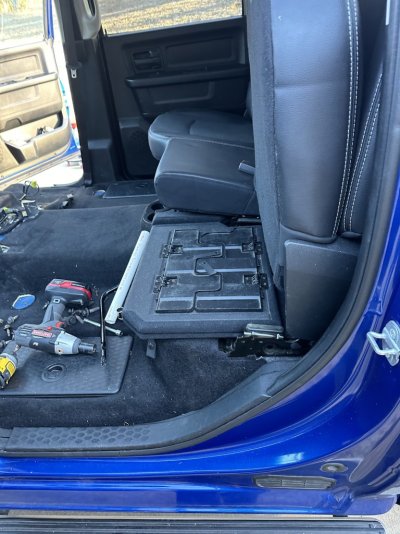

Still fine tuning but I’m pleased so far .Thanks m2 mods for the harnesses and the help ! IMG_1758.jpeg

Looking good so far. ... You really did get a nice set of seats!
