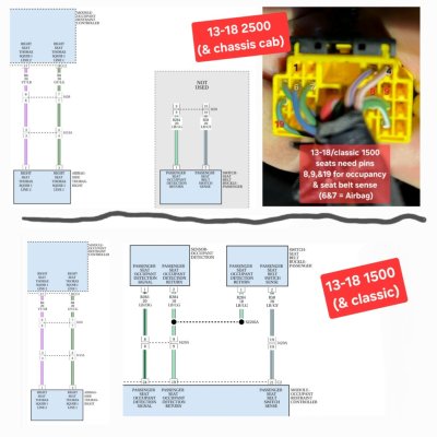

FYI for those with a 13-18/classic 1500 DS doing the 4th Gen 13-18/classic heated seat swap ...
Make sure the seats you use are from a 1500 (or check the pass.wiring first) because Chassis cab (commercial spec seats, ie some 2500+) most likely don't have the needed Passenger Seat Belt Sensor and Passenger Seat Occupant Sensor and wiring! (May just be Chassis cab Heated seat set issue)
Check the seats you're buying for needed wiring at passenger seat connector i420 pins 8, 9, & 19 so they match up with truck side connector, otherwise you will get a service passenger/occupant sensor airbag fault.

This summary from @mjf6175 is typically what to expect (minus the odd situation mentioned above from one customer of mine)
-2500's (like mine) come with seat belt sensors and airbags so they are not different in that regard.
-3500 chassis/cab (no pickup box) do not have seat belt sensors OR airbags. 3500 chassis/cab is considered a commercial truck. All 3500 WITH a pickup box will have seat belt sensors and air bags
-2500 chassis/cab I am not sure of these, BUT there is a quick "TELL". Its a visible airbag label that is sewn into the backrest seam (just below the shoulder area of the seat) on the door side of the seats. If the tag is there it has airbags and it will have the sensors.

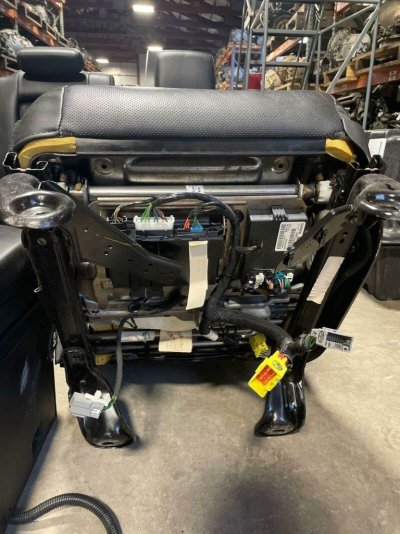

Example of correct 13-18/19-24 classic Laramie/limited driver seat connectors/bottom view. DON'T buy 09-12 seats or 5th Gen seats!
... (This one also has the extra "memory seat module/MSM" and extra 6 pin connector with green wires to support heated rear seat console switches).
