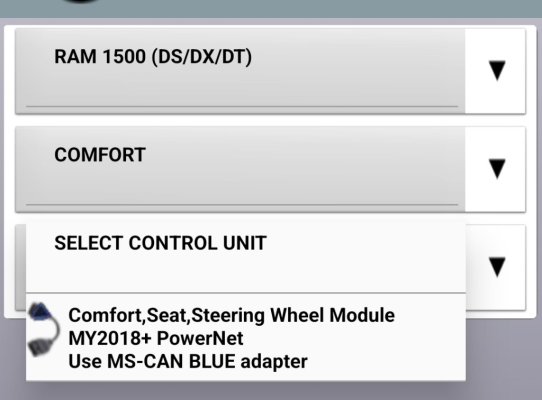

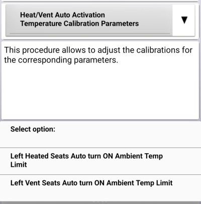

I haven't seen anyone try it yet but there are some settings when connected to the Comfort Seat and Wheel module (CSWM) or "Comfort" module directly.
Use at your own risk

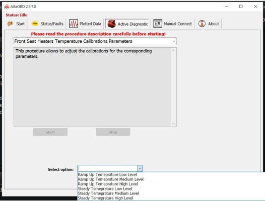

I think we need a larger pole to determine if this is the case, not just a few subjective comments. Also, see the AlfaOBD settings below. If this setting is set to 'Ramp up', who knows how fast it will arrive at toasty cheek levels versus the steady setting?
My wife's 2010 Dodge Charger R/T AWD Hemi has heated seats, and those seats get hot fast and you'll end up turning them down to the low setting.
On my '21 Warlock, when it's far below 0°F, even while wearing shorts, I don't last more than a few minutes on the high setting before I need to switch to the low setting.
I may explore this 'Ramp up' to high setting.

Function: "Comfort"; Comfort, seat, steering wheel module: MY 2018+ powernet; Steering Wheel Temperature Calibrations Parameters; then select options
As I stated, there is no selection for anything older than '18.
