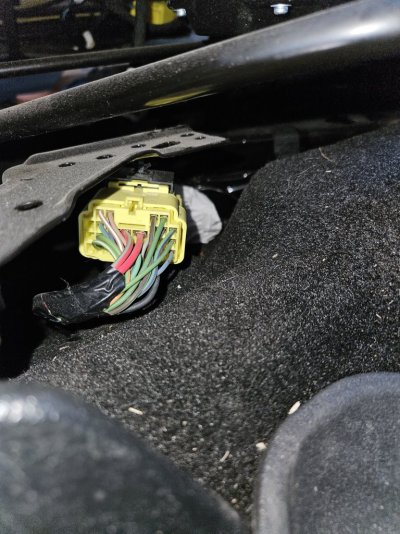

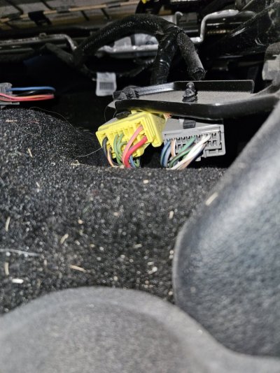

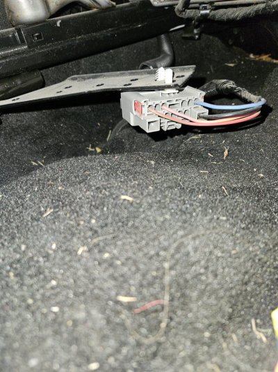

these are my underseat connections... I've found some 2011 Laramie mega cab seats with front heat/vent and rear heat. I know I'll need wiring for the rear but I'm wondering if the front will be plug and play

Usually 13 to 18 seats most will come with the module in them Laramie trim model with the center console for the rear heated seats .from what I read the big horn may have the wiring . But verify with @Mpgrimm2 he can make the harnesses you may need and a wealth of info . But read the thread completely

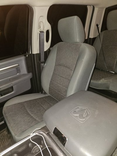

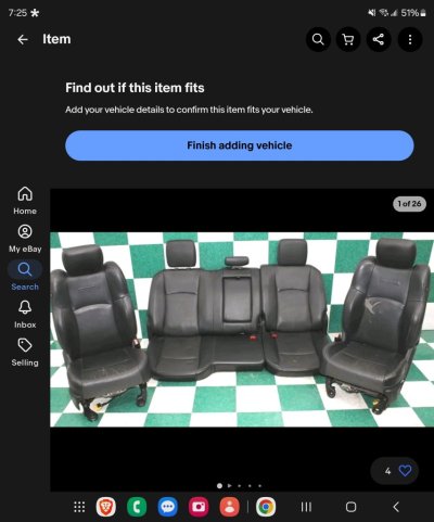

this is the seat I currently have in my bighorn... looks nothing like the buckets on ebay
blurz.......your have the standard seats in your Ram. The standard seats can come as a bench seat with the center section (third seat) which has a backrest that can fold down or left up as a seat; and the standard seats can also come with a center console as shown in your pic. I had the same setup in my Ram, standard seats with a center console. I installed Laramie seats like you want to do.
Laramie seats also come with either a center fold down section or with a center console. In essence there are 4 combinations of seats:
1) Standard seat with a center section
2) Standard seats with a console
3) Laramie seats with a center section
4) Laramie seats with a console
All of these combinations will bolt into the Gen IV cab with the exception of Gen V 1500's which has different mounting brackets and electrical plugs.
The ebay pic is Laramie seats (year?). They could have come out of a Ram that had either a console or the center fold down section that was removed. That center fold down section is made with brackets that ties into the passenger seat and driver seat. If that center section is removed you are left with just the buckets and are the same as the Laramie seats in a Ram with a console.
Hope that helps.................
