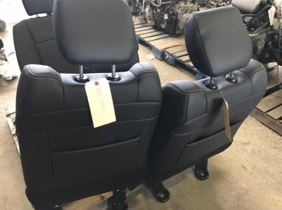

Adding Heated/Ventelated seats and Heated Wheel to Express/Tradesman
Well I finally got another set of seats, these are out of a 2015 CC. Casey from seats and such and I came to a amicable agreement with me getting partial reimbursement and keeping the 2014 5500 seats. Casey was more than fair and I thank him for that. The new set came with a backseat which I have no use for so I will be selling both the buckets and backseat in the very near future, all are like new.
Not sure why the memory worked for me and not others? Prior to swapping them out I will take screen shots off all the options that available for both sets and see if the memory still works on the 2015 seats. I am also curious to see if they have the same modules and if the 2015 seats have the added options to change fabric type etc. Seats are coming by the end of the week, so possibly this weekend. Still waiting for my refund from LKQ!IMG_0989.JPGIMG_0990.JPGIMG_0994.JPGIMG_0992.JPGIMG_0993.JPG

Cool! It's good you're finally getting a good set of seats.
As far as the options go, I expect you won't see anything different. Those live in the BCM and not the seat module, so it's a function of the truck's MY. The heated cloth ones I have right now are from a 2015 but I don't have any of the extra stuff.

Can you take a shot of your harness going into the seat module. Im curious to if your trucks side is completely populated, and if it is why!

Ok not that concerned but something just caught my eye? The backseat does not seam to have the fold down center armrest / cup holder? Am I seeing things I thought all Laramies had that?
For the base seat install, 9 slots are populated. If everything is populated, then you have rear heated seats, memory seats, and adjustable pedals.
If the Laramie seats are out of a Quad Cab it will not have the center fold down section in the rear seat. That is only available on The Crew Cabs.
That's why I don't understand why cptwing would have the wiring. There are no regular cabs with those options, so there is no reason why such a harness should exist.
