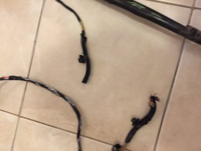

Can you post a few pictures of the wiring that you do have?
Sure.
Those two cut ends suppose to go to the rear seat heating and something else
I am pretty sure I have the connectors and pins to replace the ones that were cut off. Shoot me a PM, and I'll see what I can do for you. Were you really going to try and swap the whole body harness in your truck or just strip out the wiring that you need?

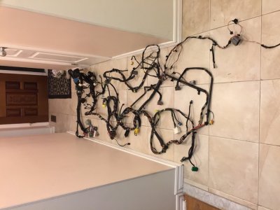

I was planning to swap a complete harness, but now I'm not sure what i'm going to do.

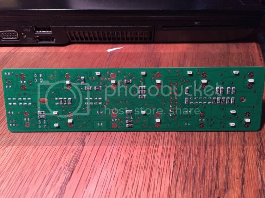

Hard to say, I know my XM was working fine until I hit something that looked for Uconnect and then my XM radio went away and I needed to pay for a subscription :flipthebird: As far as your dash switches I'm betting the dash switches are programmed individually for the combinations of options, also the boards are not all the same. See my factory board below, it had only 4 switches yet more than 4 switches are populated with LED's.(all the little white chips are LED's) also note the lower row has some spots populated with 2 LED's for the heated seats but not the cooled seats.
I gave Benny the year of my truck and the options I wanted and he got me the part number to order. Once I swapped it with my stock switch all the switches illuminated properly, they just didn't stay on. Once I swapped in the factory 8.4 bezel and 4 spd harness the heat/cool seats worked :happy107: (I need to mention my 8.4RA4 took a rest for 1/2 a day before the volume started working again) I'm, a happy camper now :favorites13: This forum and it's members have been most helpful and supportive, a special shout out to Mike & Mike for the great work they are doing, I wouldn't be this far without them :favorites13:
Well today none of it is working. Not sure if it is doing the turn on for 20 seconds before going off. Since none of the lights work. Seemed like everything sort of reset. Had to go in & get my XM radio switched. XM was working & then shut off. Also my Aux input isn't working. Not sure if getting them all turned on for soft keys will make them live again or what?
