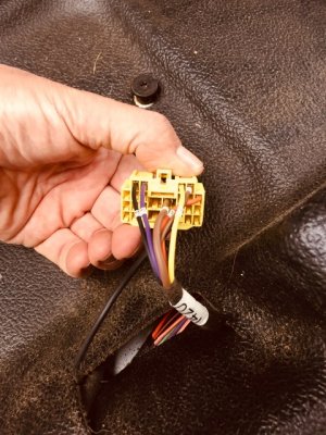

Had a open day & put in my Limited front seats in 2014 3500 CC! First I deeply appreciate and applaud ALL who have contributed to this endeavor! A wealth of knowledge in the thread! 2nd a huge shout out to grimms2 Mp for the high quality plug & play harness! And his A1 customer service! Thank you Mike.
I stumbled a bit when it came to navigating alfaobd menu’s..... Once the menu selections were done a few times the programming... turning on the options went well!
After a few key cycles and a trip down a country road, the Hickups begin?
1st I have the seat heat & vent icons on the Ra4 radio screen, tap to select, either one, they will come on for 10sec then shut off?
2nd the radio volume quit working on wheel switch and volume knob on radio, when on the short drive. Then hit a few road bump and it started work again...hmmmmm?
Anyone have this happen, how did you resolve it?
Thanks Dave.
PS. I need Black console, or Limited lid?
3901DD1D-30CD-4618-B3B8-AD032B5E5FBF.jpeg BD391B84-C657-45F5-94E8-3274B056160D.jpeg BDDF8993-5161-439B-9BA7-E1D3C5F35BED.jpeg 2CD602E8-EF18-48A5-A392-AD36CC03EB7F.jpeg F536135F-9A76-4488-A9F9-F768A76E7232.jpeg

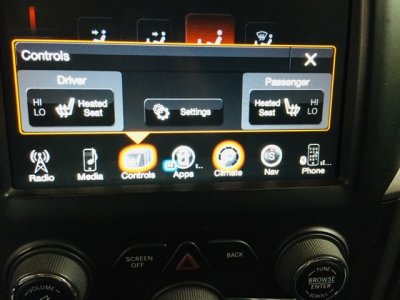

Pic of the seat icons on the Ra4! The icons also appear in the apps too. Vent & heat seat icon.

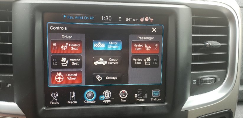

Did you activate the vented seats? You mentioned the heated seats turn off after around 10 seconds. Do the vented seats work? Also if the vented seats are activated they should also appear on the controls screen as well as the app screen. This is a pic of mine. It looks like only the heated seats are appearing in the pic you posted. Another thing I noticed is your controls screen only fills half the screen when selected. Every RA3/RA4 I've seen or worked on filled the whole screen when controls is selected no matter how many icons are on the screen. As far as your heated seats not staying on it can be caused by a few things. Are you sure you enabled all the codes? You can refer to the first post of the Alfa thread under known working codes to verify you didn’t miss anything. I would also go back and check all your wiring to make sure you didn't accidentally pin the wrong connector in the PDC and seat connectors You can also use the Alfa tool to connect to the drivers seat and check for DTC codes plus run diagnostics.

Thanks Rick, yes I went back through the alfaobd menu’s and made sure the List of options provided by Mike when he sent the new harness were all present. Went for a drive this morning and yes my climate screen looks just like your when the sea at icon is selected. Better yet both the vent and heat functions work at all the levels! Thanks for you input Rick! Enjoy your weekend!
